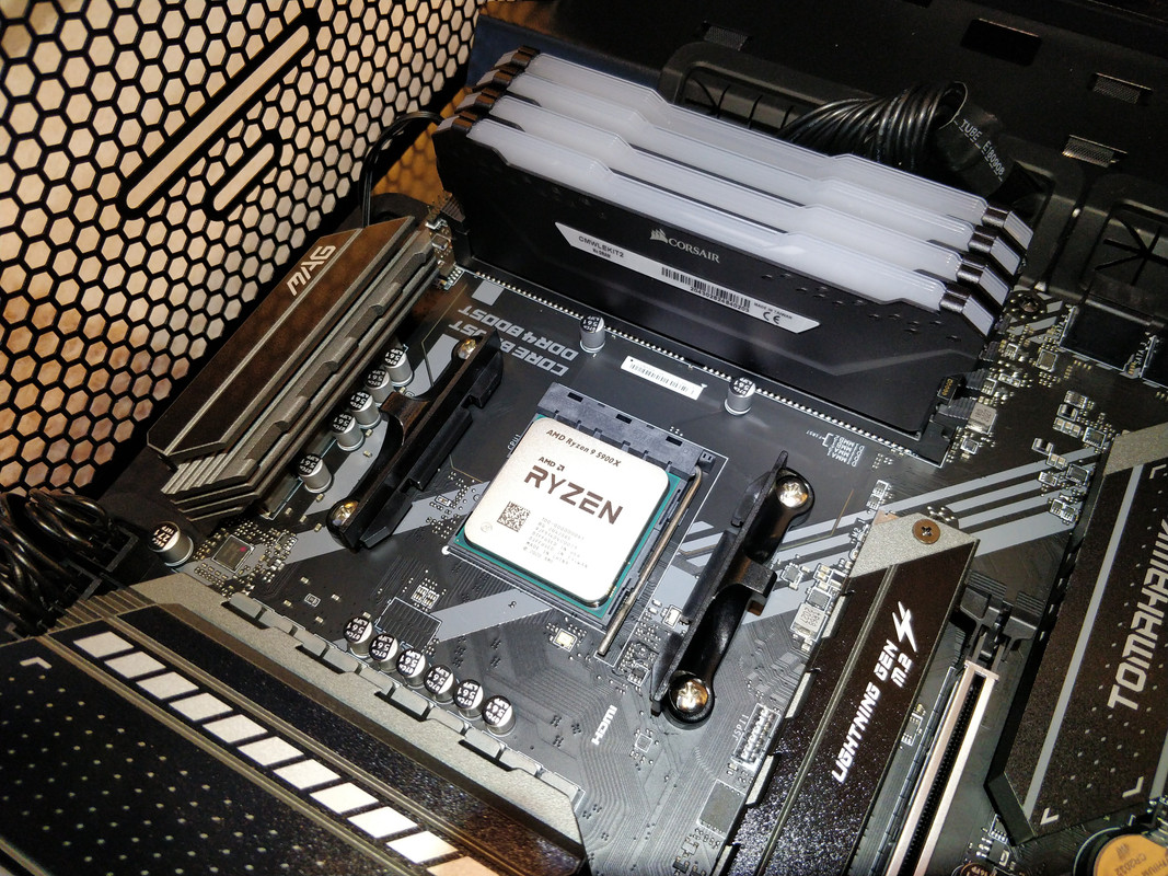

The final spec of the new build was decided and components bought last month(with the CPU purchased on launch day):
CPU: Ryzen 5900X ( somehow managed to get one on launch day from OCUk, shipped the day after launch)
Ram: 32GB Corsair Vengeance RGB Pro (2x 16GB 3600MHz) + 2x dummy RGB modules

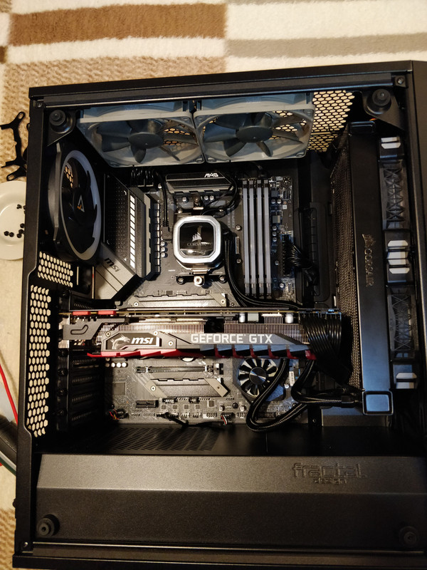

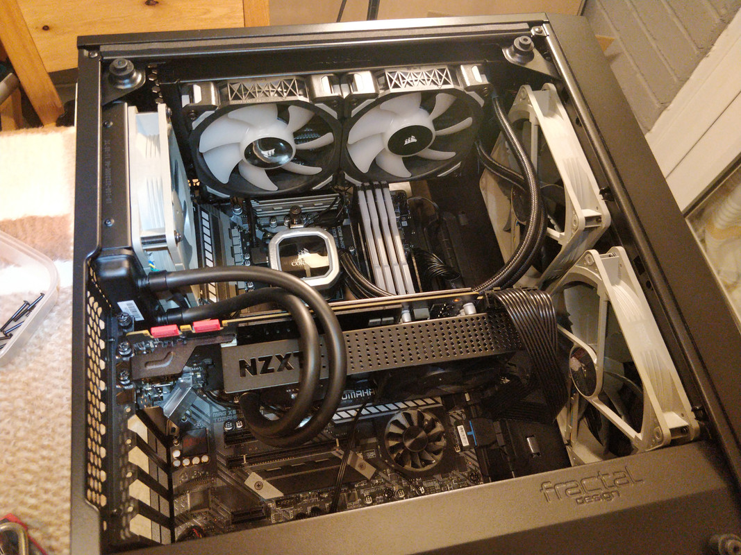

These are the photos from my first assembly:
Now, this looks like it should have worked.....but it didn't.
I assumed the two noctua fans + the antec prizm fan for the exhaust would be enough to get rid of the hot air generated by the GPU in this case. Nope, absolutely not what happened.
At full load, the GPU was COOKING. Like, with the side panel closed in just couple minutes the temperatures were hitting 84C which is the thermal limit of the 1080Ti, and the whole thing would throttle. And of course the fans were running at 100%, so it was super loud. Not good.
So...after few days I decided to rework everything about cooling in this case, and install water cooling on the GPU just to have it nice and quiet. I was concerned whether this case would actually fit another AIO in there....but yes, it absolutely does(although it's a little bit tight).

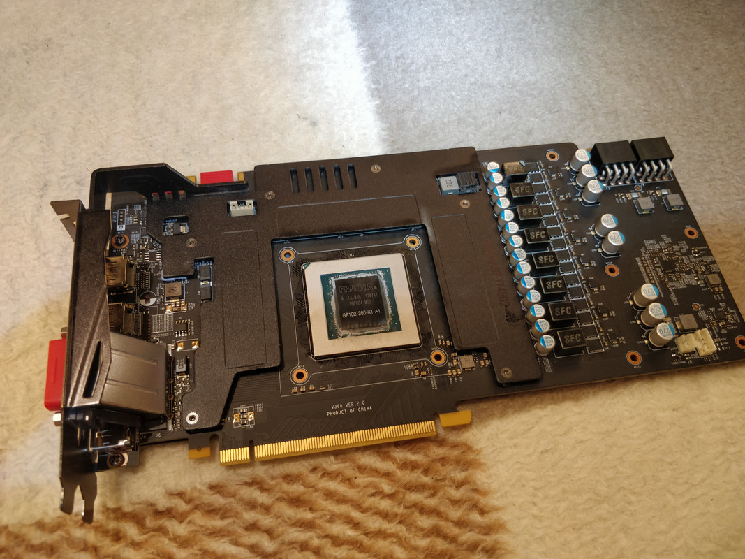

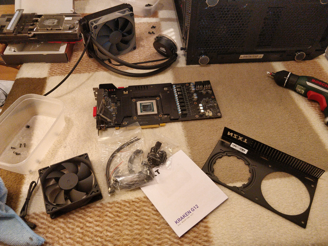

First I had to remove the shroud from the 1080Ti, which was a first for me - there's something scary about removing cooling from the GPU, it feels very fragile for some reason! But as it turns out, on the Gaming X it literally couldn't be simpler, it takes 4 screws around the core + 3 on the edge and the whole thing pops right off:

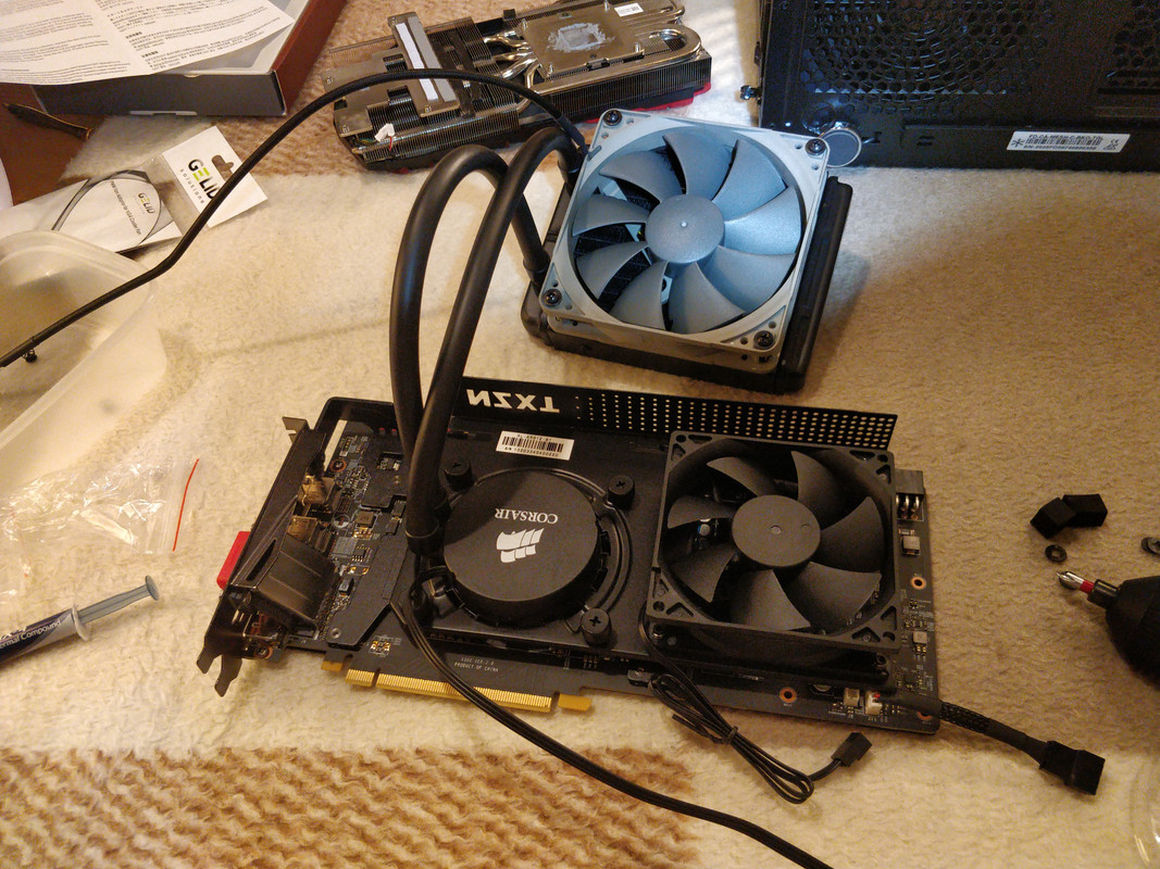

Installing the G12 was relatively straightforward:
And voila, Corsair H55 installed on my 1080Ti, about 30 minutes of work total:

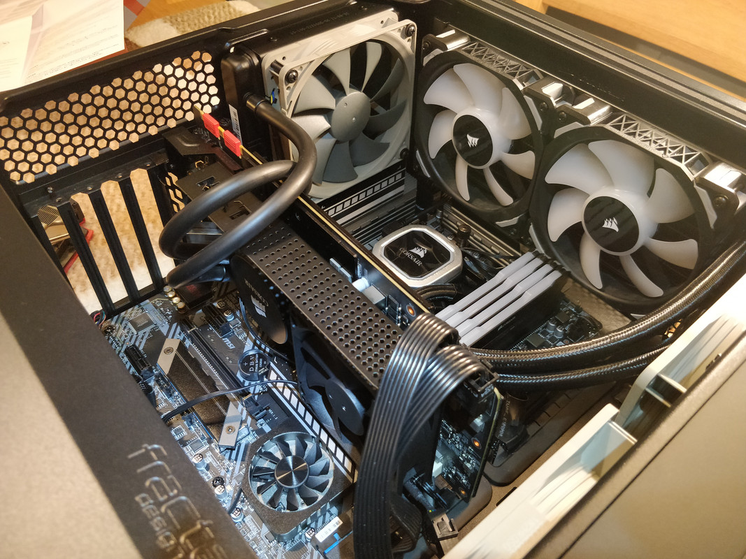

Now, it was time to assemble everything(like I said, it was a pretty tight fit with both the rear and top AIOs having to squeeze next to each other:

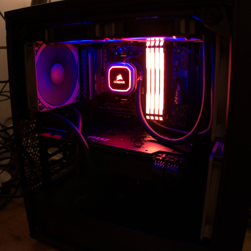

And.....it all works and is absolutely beautiful:
