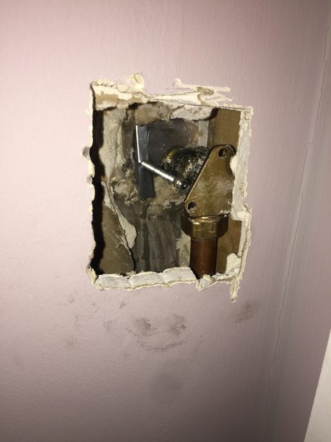

Well this turned in to a horrible job. Thank you to Abyss for your spring toggle suggestion, it worked a treat.
It didn't quite go to plan though as the pipe in the wall was weeping. Not a lot, but enough for it to drip and create a puddle on the floor when I was testing the shower. I checked my fitting 4/5 times and applied PTFE/LSX as I couldn't see where it was leaking from.
Here's what I ended up with:
I had to cut out the plasterboard from the room behind (I'll neaten it and take it back to the joist to make it easier to reboard it) to get access to the nut. There was no other way to get access unfortunately.
Note how a huge channel of plasterboard is missing from the tile, looks like they have either had a leak previously or for some reason it was removed when it was tiled (perhaps to get to the pipe?).
I moved in nearly 3 years ago and we haven't used this shower once as the pressure was poor but now we have an unvented cylinder which will allow us to use this.
I also siliconed the bath and noticed a leak under the bath waste so I'll replace that as well.

Believe it or not, that's what I used to make the hole! It was one of those which got bigger and bigger as I tried to get enough leverage on the nut.
I'm confident it will look fine once it's all sorted. Like you said I need to monitor it for a while. Might even have to make the hole bigger if the fitting needs to be replaced.
