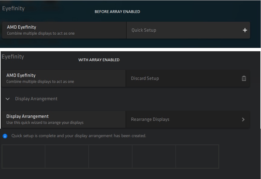

I have 5 monitors plugged in to this:

On every version of the AMD software that I've tried since then Eyefinity advanced settings are NOT included. So you can either start a monitor array using quick set up which includes all five screens as one. Or you can discard the set up.
At no point am I offered any other options, no advanced settings, no ability to choose which monitors to include or exclude from the array.
