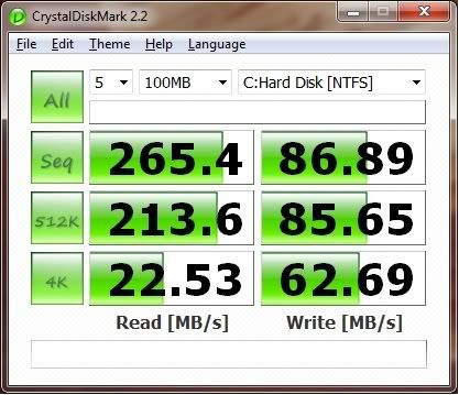

I have just setup an intel G2 80GB in my system today. I set it to AHCI in the bios as I have two esata ports running off the controller and I read its perfectly fine to set AHCI for G2 SSDs.
After installing windows 7 Pro 64, Defrag was set to Manual. I followed the instructions copied below and disabled it so there was no chance of running it by accident:
Disable defragmentation
Description: Defragmenting a hard disk's used space is only useful on mechanical disks with multi-millisecond latencies. Free-space defragmentation may be useful to SSDs, but this feature is not available in the default Windows Defragmenter.
Instructions: Start Menu -> Right-Click Computer -> Manage -> Services and Applications -> Services - > Right-Click Disk Defragmenter -> Startup type: Disabled -> OK
I get the scores shown below and am happy with its performance:
My defrag scheduler won't let me allow me to select the SSD drive. Thats all great but the Superfetch service is still enabled. Also C:\Windows\Prefetch is filling up with files. :(
The WEI for the SSD drive is 7.3. It was 6.6 before I switched to AHCI.
By the way I think running the Windows Experience tool has a bearing on whether Windows detects your drive as an SSD or not.
