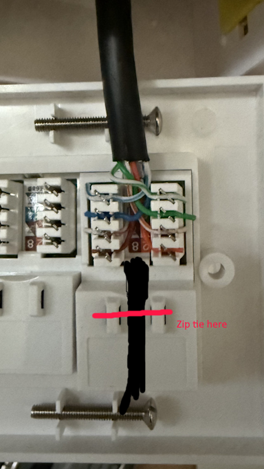

Never seen that type of 'connector cap' before, what brand is it?
Your wall port termination, missing the zip tie..

No cap for that one. You punch down straight into it. I ripped the wiring out tonight after what Silicon Si said and tried again. Punch down this time round was far better, cleaner and the wire was the correct way round to use the cable tie. According to the cable tester, it’s an even bigger failure… I don’t think this end is the problem as it’s pretty straight forward. Either the cap isn’t seating properly at the other end or there’s a break in the cable somewhere. Might just rip the cable out and put a new one in to eliminate that possibility.

I haven't used those connectors but this looks wrong to me, using either T568A or T568B pin 7 should = white / brown and pin 8 = brown, so why in the photo is the white/brown wire on the outside where I would expect pin 8 (brown) to be?
As others pointed out this isn't a good connection, the cable is from the wrong side, some of the pairs have been untwisted more than necessary, it han't been punched down very well, the cable tie is missing and its the wrong type of socket for shielded cable.
Using the punch down tool takes a bit of practice before you come proficient.

Unless you crushed it when clipping it to the wall, damaged it with 90 degree bends where it went outside or something has chewed the cable I would have thought the way its terminated is more likely to be the issue.
