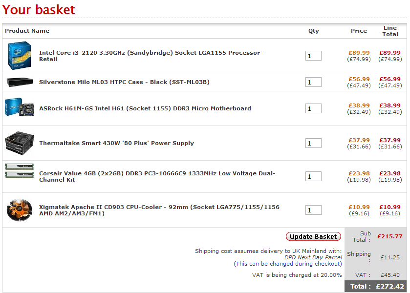

I've currently got my Pi running RASPBMC but the lack of 1080p/DTS decoding is a limitation (and I'm not sure if the DTS folks will grant a license to the Raspberry Pi). So I'm looking at either
Prepackaged solution (WDTV/ATV)
HTPC box
Both on conjunction with a NAS.
I have a SSD I can use. Will the above fully decode 1080p DTS with ease?
Thoughts?
Thanks guys
Could be wrong, but I don't think you'll get hardware GPU acceleration on H61, however I don't think the i3 needs it in the first place.
