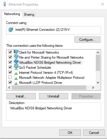

Well now I feel very stupid.
I was just messing around with it and saw that whenever Hyper V is enabled, the proporties for my Ethernet Adapter had these top 5 boxes unchecked.
I don't know how I missed that. I was looking for a complexed solution when a simple one was right infront of my eyes.
Thank you both for the help. All is well with the world once again :D
