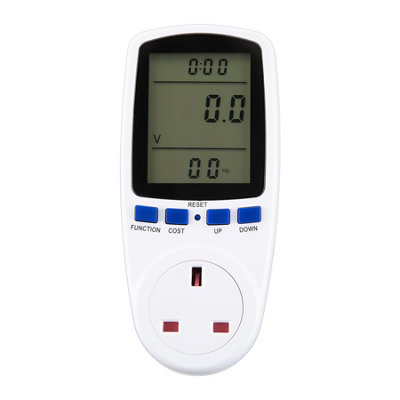

Buy a plug in watt meter they're about £10 and you get an idea how much you'll need. Remember when power goes off, drop to desktop and shut it down..
Haha yeah I know, I just need a few mins to shut it down really. What do you mean by a watt meter? I don’t have the pc yet and I’m going to buy a UPS at the same time. Since I’m already high balling the watts of the build it should be fine to go ahead with the 1000W right?
Something like this
Use your computer, idle and full load and see what UPS you might need.

You're willing to spend £400 on a UPS but not a tenner on a power usage meter?
With the power meter you can determine just how large (or small) a UPS you need. If you overspend why do would you need 45 minutes run time? Literally 5 minutes, max. Maybe worst case scenario is NAS is rebuilding an array etc where you can't switch the NAS off..but those are low power devices so if you switch PC off it should be enough.
