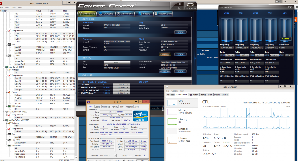

See this pic for example:

Ignore what task manager says for cpu speed its wrong.
Says mines at 7.77GHz lol

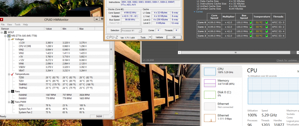

I decided to screw it and do it now as its fun haha. This is after an hour at stock voltage and 42x
Seems good temps again? :)
max of 55C
Cant complain with that :)
I notice the 12v rail of psu reads very low...dont worry about that will be a false reading by software...if it was truly that low pc wouldnt boot/run at all :)
Noticed also TMPIN1 has max reading of 87c? dont know what that sensor is for though...in previous screeny it showed a min of -89 so prob a false reading.
speedfan can be a good program also for various temps plus you can see from graphs which ones vary properly as load applied.
