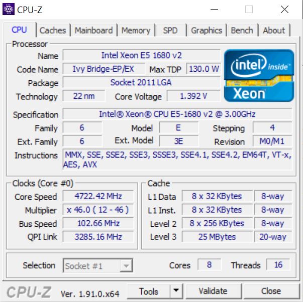

Well, ended up picking up a cheap E5-Xeon 1680V2 and switching the i7-3970x out and will sell on if this proves a good chip, currently runnung 4,500mhz on all 8 cores now, 100% stable after an hour, temps within reason, so lets see how far this Xeon can go... I'm excited... hahaha basically if I sell the i7-3970x it means I've got another 2 cores for free :)
Well, seem to be getting some speed out of this badboy at minute... just hit 4,700mhz. The weird thing is with these chips is, you can run 4,500mhz on 1.310v... to hit 4,600 and above requires 1.385v and the temps start climbing by around 10C on max load after 10 minutes ish... so will put some new 2,300rpm fans on the heatsink tomorrow and see what I can do... be nice to run 4,700mhz, but I'm not having the temp in 85c plus range, always like my Intels in the 70's even if it's high 70s!

Yeah got it running stable topping out 4,[email protected] which is perfectly acceptable or 4,600mhz @1.385v which is quite a leap, I can't hit 4,600mhz with anything less... so for me, really, for the sake of 100mhz... and lower temps, stress etc, other than for benchmarking may as well just use 4,500mhz and be a happy man!
Under load, at 4,600mhz, the vcore is 1.368v, however, not sure I fancy rocking that 2/47 tbh as this is a 24/7 machine... so, reckon I'll keep this this week, make sure all is good which I'm sure it is then sell one of these spare chips, sitting on an i7-3820 quad core and an i7-3970x six core processor, may as well get up for sale soon I think.

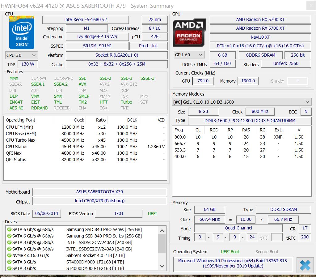

I can't remember off the top of my head is there any difference with AVX/AES extensions, etc. to your old CPU that might have an impact on some newer software?
Yeah originally I thought the same, however, judging by this (ok it was the model lower than the i7-3970x, however same series), however it seems the Xeon seems to have more, how reliable this is is another matter and doesn't match up with INTEL site.

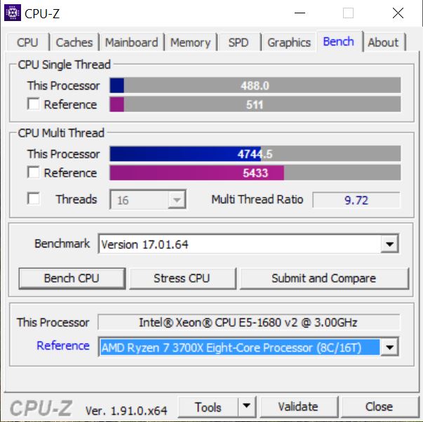

Settled on [email protected] as my 24/7 setting, however, it will run and benchmark at these speeds on all cores! WOW! Not that far behind the Ryzen there tbh, makes you wonder how far we've really come, however that's me done. This chip is a keeper!
