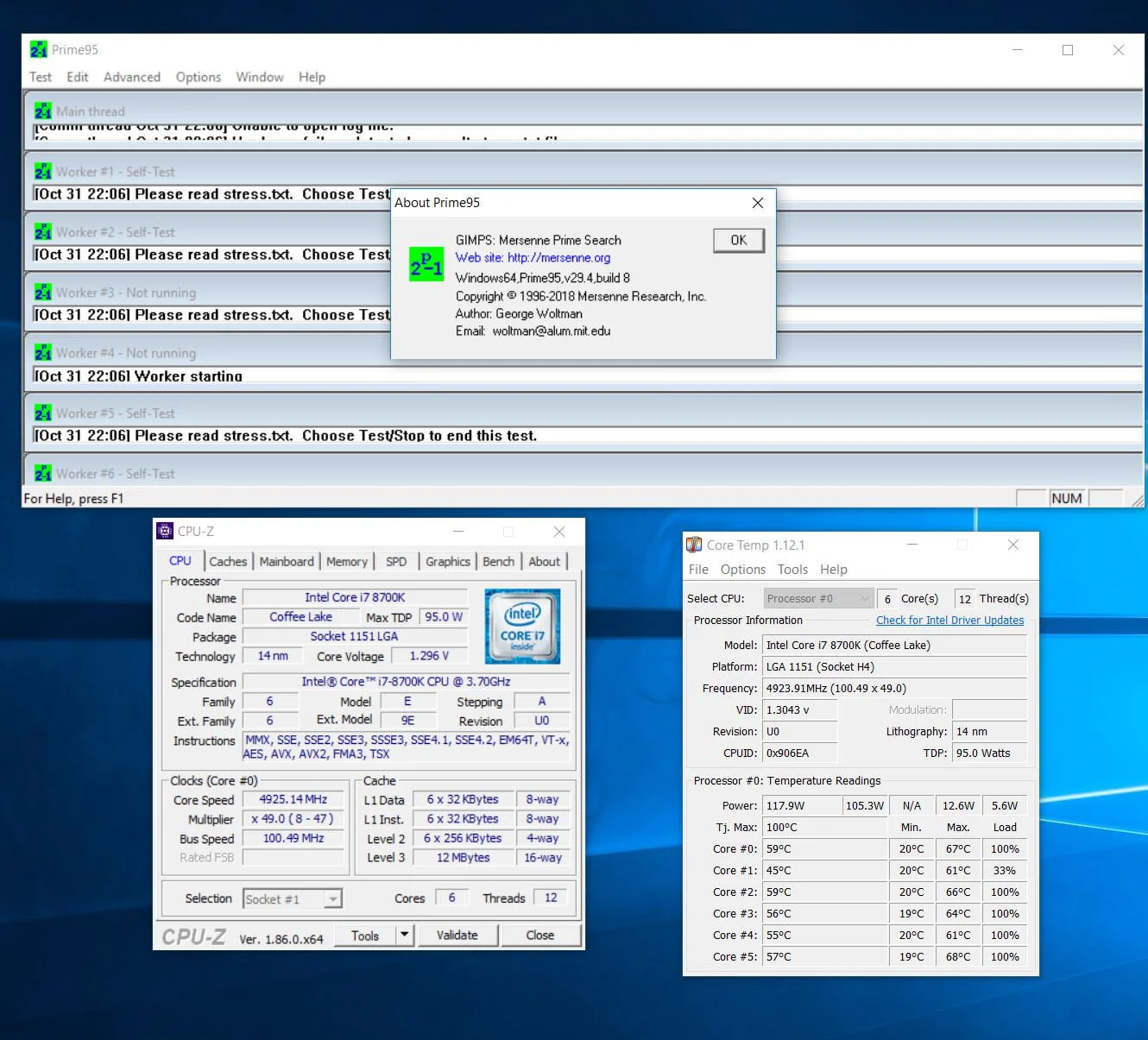

Here you go. My I7-8700K. running the latest version of Prime95 (AVX instruction set) on a half decent air cooler (after about 25 minutes). Though it's pulling slightly more than 1.28v (as expected for a power hungry program like this).
It will run higher than 4.9 But needs either big volts, or an AVX offset. And my motto is "if it isn't stable in everything, then it aint stable" (quite aware that other peoples opinions differ, as is their right).
Buy a decent cooler once and it should last for a fair few builds.
