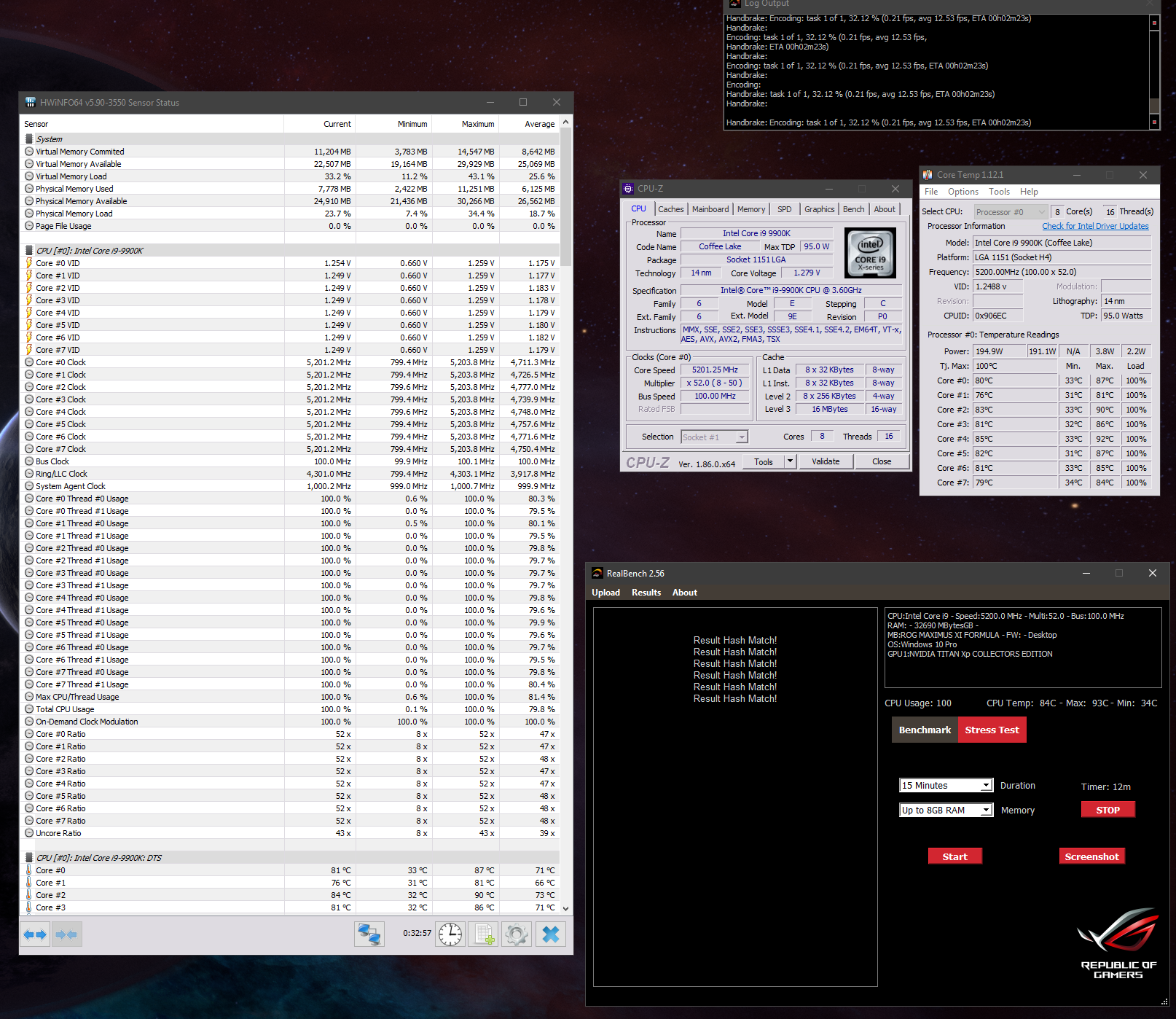

More playing:
5.2ghz core 4.7ghz cache
1.320 vcore
Realbench 30 mins hottest core average: 80 spike 84
OCCT large 1hr hottest core average 59 spike 63
No long stress test (will do next weekend to finally find my 24/7), just playing games. No crashes
More playing:
1.320 vcore
Nice, another good CPU, retail or tray?
Tray from here :) Cooling is 2x360 + 240, so that helps out a lot.

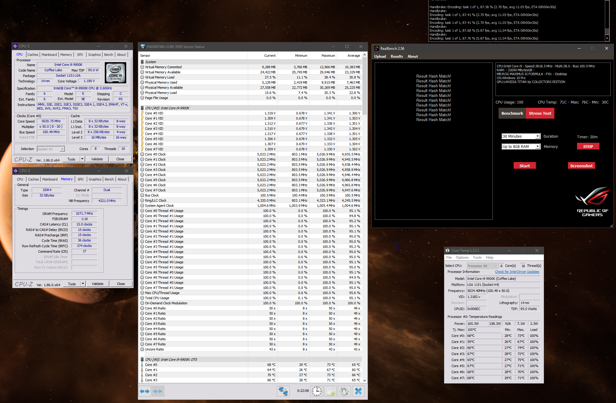

did some quick testing in my caselabs rig
reset the bios to default and only changed 2 settings Multicore enhancement to enabled and AVX offset to 0
apart from gaming i mainly use my rig for x264/5 encoding so i am only interested in AVX stability (which should also mean gaming stability)
So far chip does 5ghz avx at around 1.312v (hwinfo) not changed any of the voltages or LLC or anything all on auto and passed 30mins real bench
will try some more in the morning but i'm aiming for 5ghz avx for 24/7 stability might do few suicide runs up to 5.3 or something to see how high i can get it cinebench stable tho
