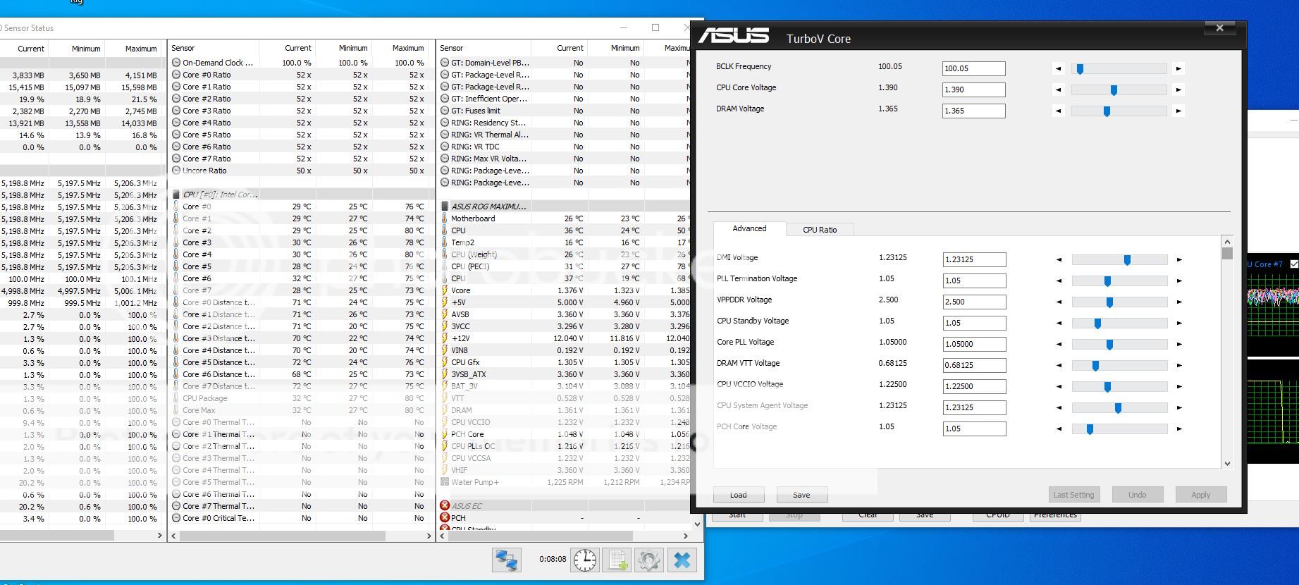

just to clarify i am not using any AVX offset at all currently in the bios the AVX offset is set to 0 this is for all my runs from 5Ghz to 5.4Ghz
im running RB in the screenshot its 12mins into a 15min run if there was an offset it would show

To get cache stress test to run with the core at 52 and the cache at the 50 multiplier for over 30 minutes I used 1.390v in the bios, in Windows this shows between 1.368v/1.376v. LLC7. Under stress load the voltage was 1.332v.
