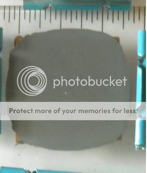

Application METHOD!
Proper application is critical to optimum performance. Squeeze, onto the center of the CPU, an amount of IC Diamond compound about the size of a pea (5.0mm to 5.5mm or approximately .2ml on the syringe) on the center of the CPU where heat is most concentrated. Place the heat sink on the CPU and press it down to spread IC Diamond over the CPU's surface, (caution: do not remove the sink to check the spread as it will introduce air into the joint). Clamp the heat sink and power up the PC.
Note, the 5.5mm example relates to a 30mm X 30mm square size. For larger or smaller square sizes you would ratio the amount i.e. 15mm X15mm = 2.75mm 1/2 pea size

Application METHOD!
