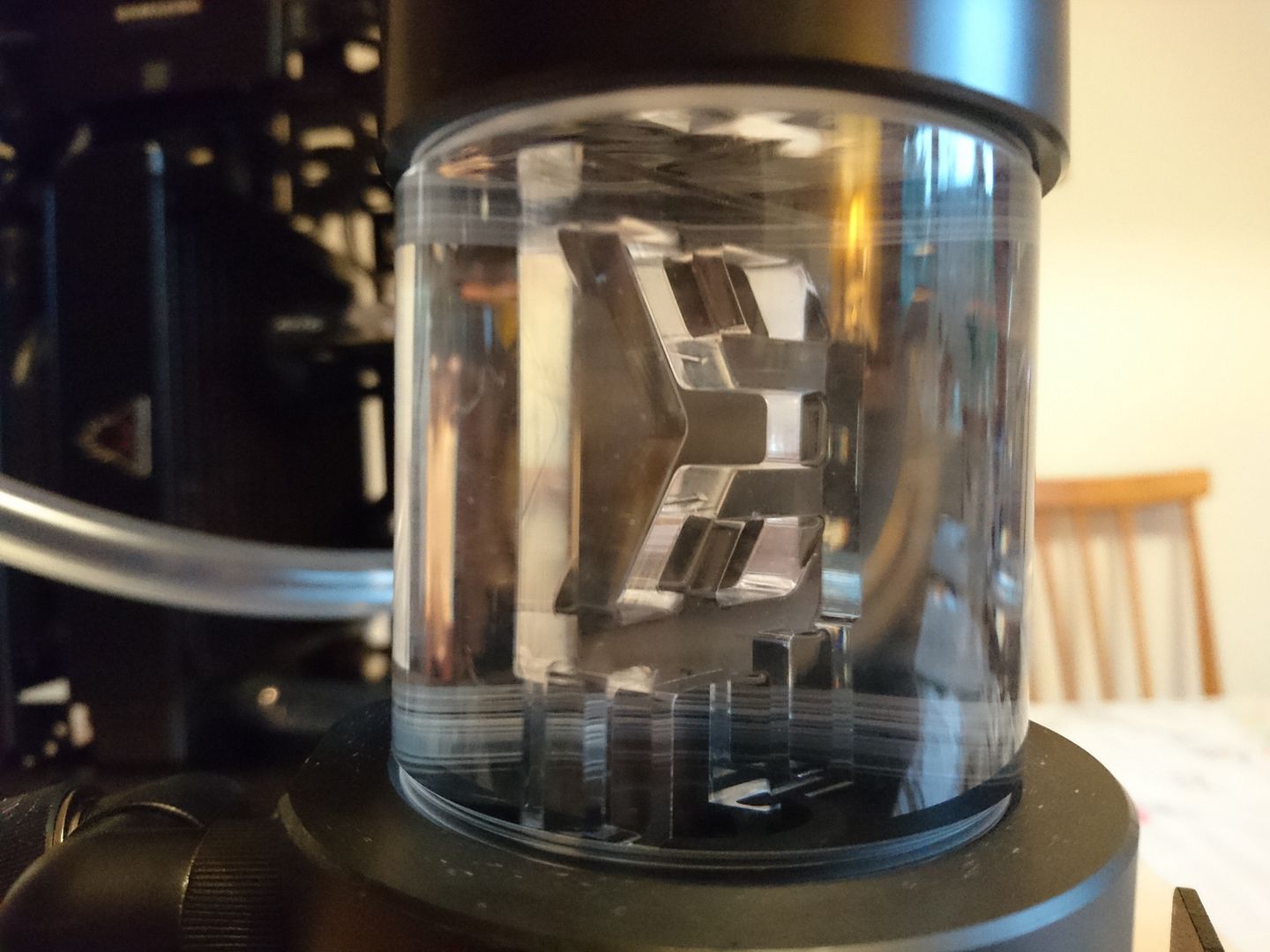

Just got back from holiday. Here are a couple of photos showing bits in the reservoir and GPU block.
hmmm, do they actually move around or attached to side of the res ?
A filter wont do nothing if they are stuck to things.
Hard to tell , ta for the effort thou.
I would say maybe blitz clean might be the way forward.
What you see in the res remains static.
There are really small white bits in the GPU block which are strand like in form. They're too small for my camera to pick up but are visible with the naked eye and they move around.

So, after emptying the coolant there was a whiteness to the drained fluid. As I poured the liquid down the sink, the white bits started to look powdery. Could this be flux?
I set up my filtering loop and proceeded to fill with Mayhems Blitz flush part 2. After a very short time the liquid in my reservoir became crystal clear. I'll leave the flush rig running overnight whereon I will drain and complete 3 flushes with DI water before refilling with coolant.
At this stage I really hope the white bits are flux and that the issue is not related to a problem with the coolant. I don't want to have to do this again and change my coolant for another manufacturers. Fingers crossed.
