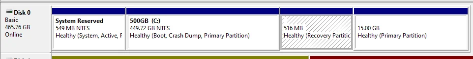

Not directly, but Disk Manager (run DiskMgmt.msc) will show all partition and it knows the Windows types, so you can deduce whether a partition has been created:
The above shows Windows installed with the first partiton (549MB, NTFS) being the hidden (well it doesn't get a drive letter by default) boot partition, the 449.72GB NTFS drive being Windows on Drive C:, the 516MB part is meant to be a recovery partition but it's got no space, and finally the 15GB is a basic Linux partition.
If DiskManager only shows the first two or three, nothing was written to the drive.
