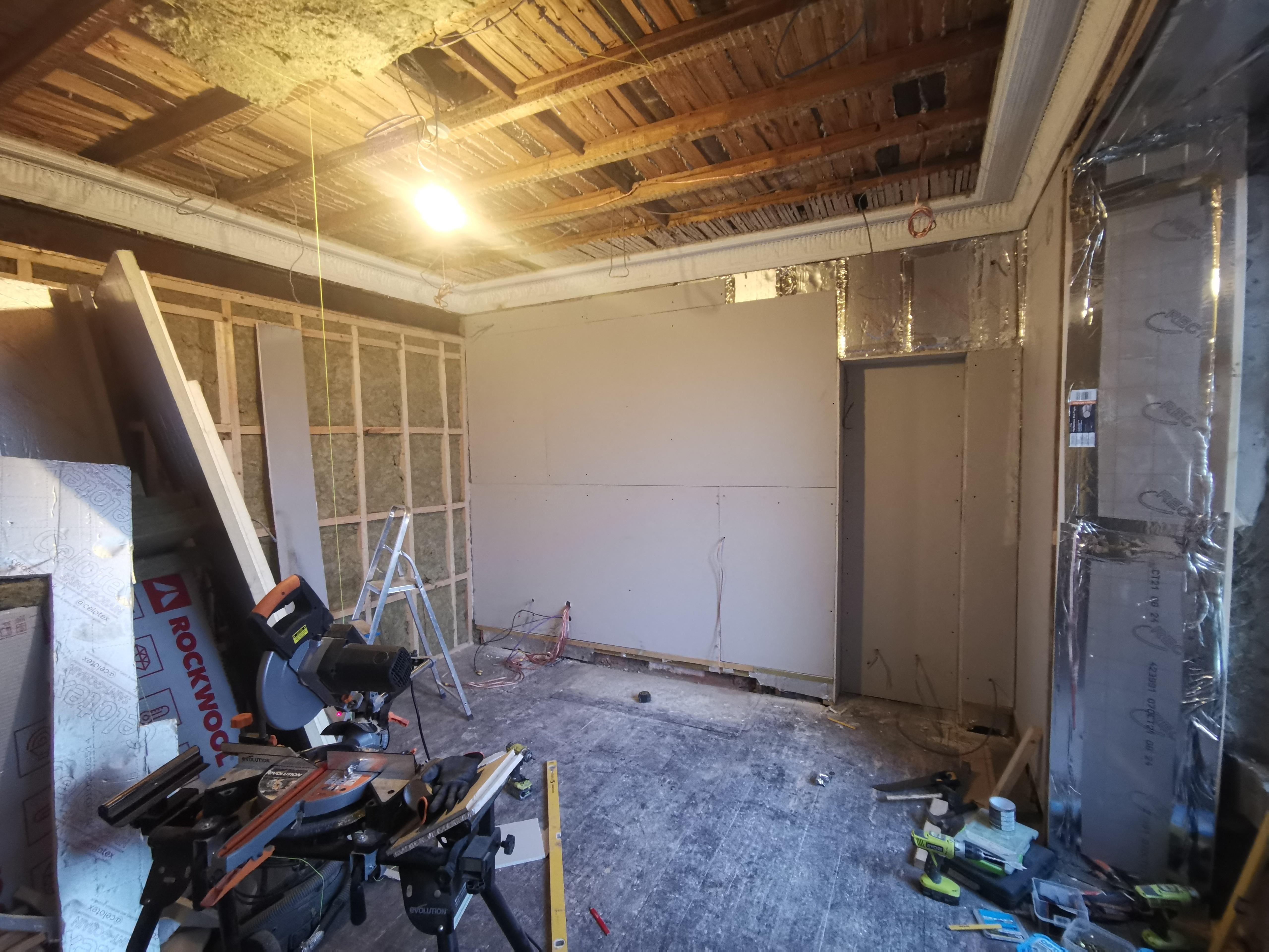

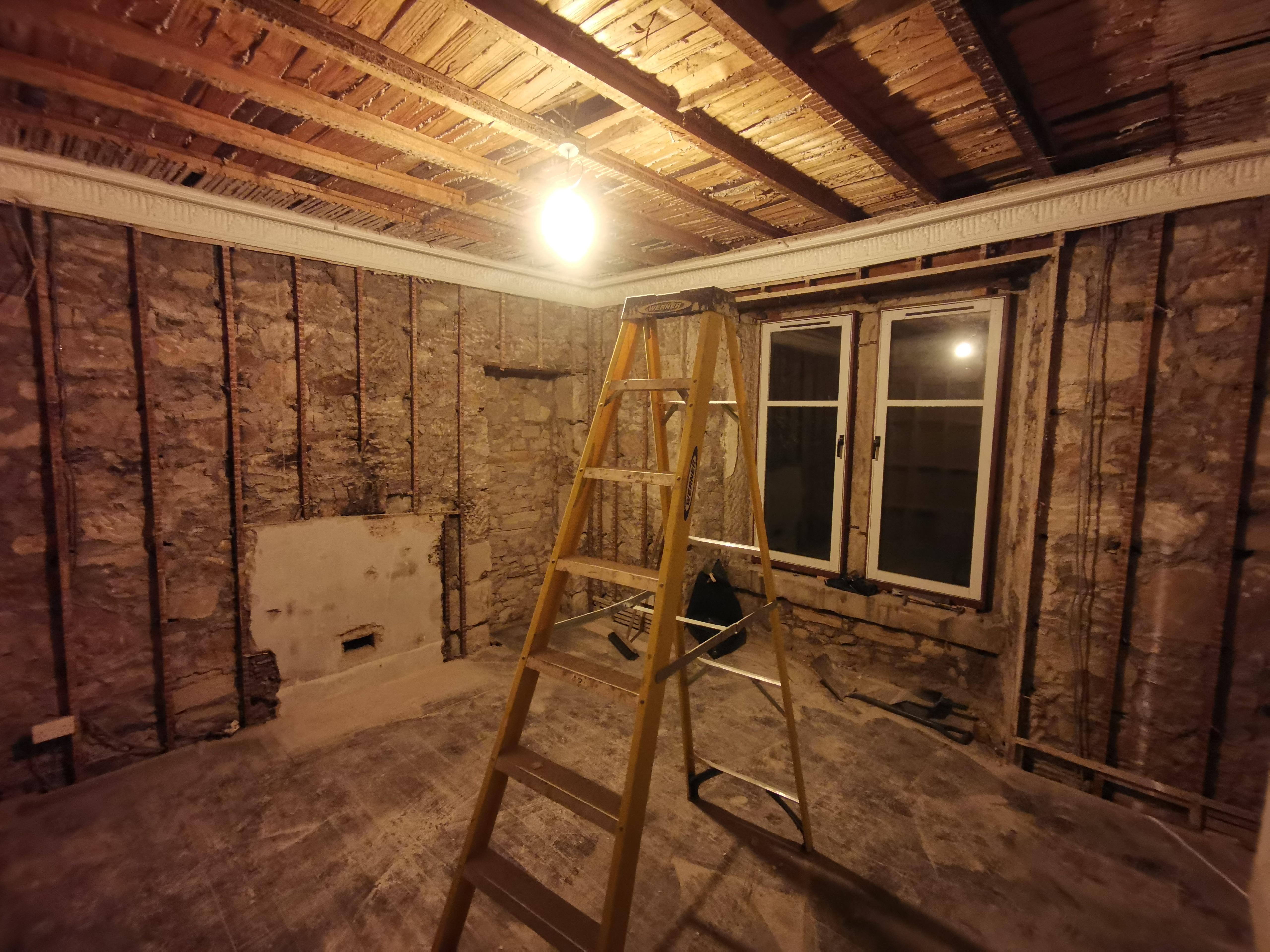

Hasn't stopped me... We're on our 6th room :eek:
And yeah, we put sound proofing between the floors and walls for room (although don't have a picture with it all in)
Nice, what have you put in behind the plaster Roy?
On outside walls i've got celotex board, all taped up, to make sure there's an air gap for the sandstone to "breathe". Then duplex board on top of that to deal with any potential moisture. Inside walls and ceiling is rockwool sound insulation then acoustic board on regular walls (not the crazy thick, 3 layered stuff, just higher density), and then fire rated board on that left wall in the second picture because has a steal beam at the top.
Oh, and I use acoustic sealant between boards on inside walls cause I'm a bit pedantic... :rolleyes:
