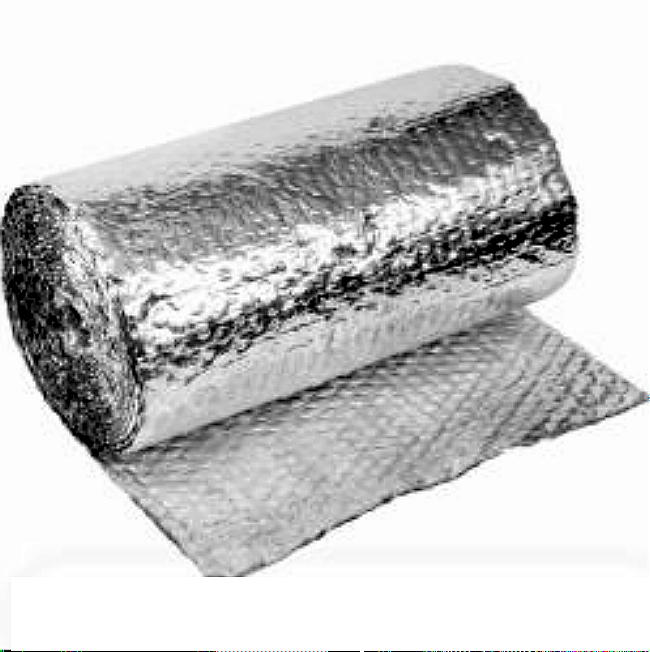

Are you talking about this kind of stuff?
I'm thinking doing similar, It'd be great if you can take a picture of your insulated door
I'll take a picture tonight although I'm stumped on how to post it!! It is that stuff - works great, I've used it to insulate interior of van etc etc and it really works.
Edit - handy tip, do it in the daytime, from the inside, with the garage door shut - that way wherever there is light you need to fill!!
