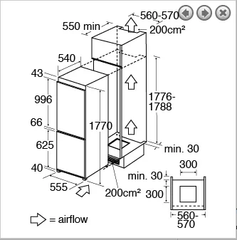

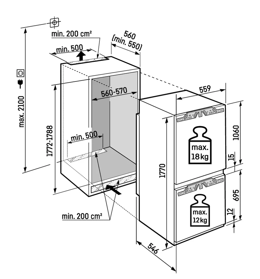

My parents integrated fridgefreezer recently gave up the ghost and I have been tasked with finding a new one.
I've found what I think is the correct one, right type, size etc.
Now, I'm wondering what it's like to install one of these things? From what I've seen online it seems doable. If I can save them £150+ installation fee by me and my dad doing it, then that's a winner. Has anyone here ever done it? Is it at simple as it seems?
And just as a quick double check, these are the specs of the old and new units, is there anything obvious I might be missing for the new one not to fit/be ok? I'm kinda stressing a bit as I have literally zero idea about any of this stuff.
OLD:
NEW:

As it's integrated then double check the depth, last thing you want is the doors sticking proud because it's slightly bigger depth.

obviously need to measure the actual receiving hole
ie. in dia new fridge is 559 wide , old was 555 - even if spec for hole width is 560-570.
