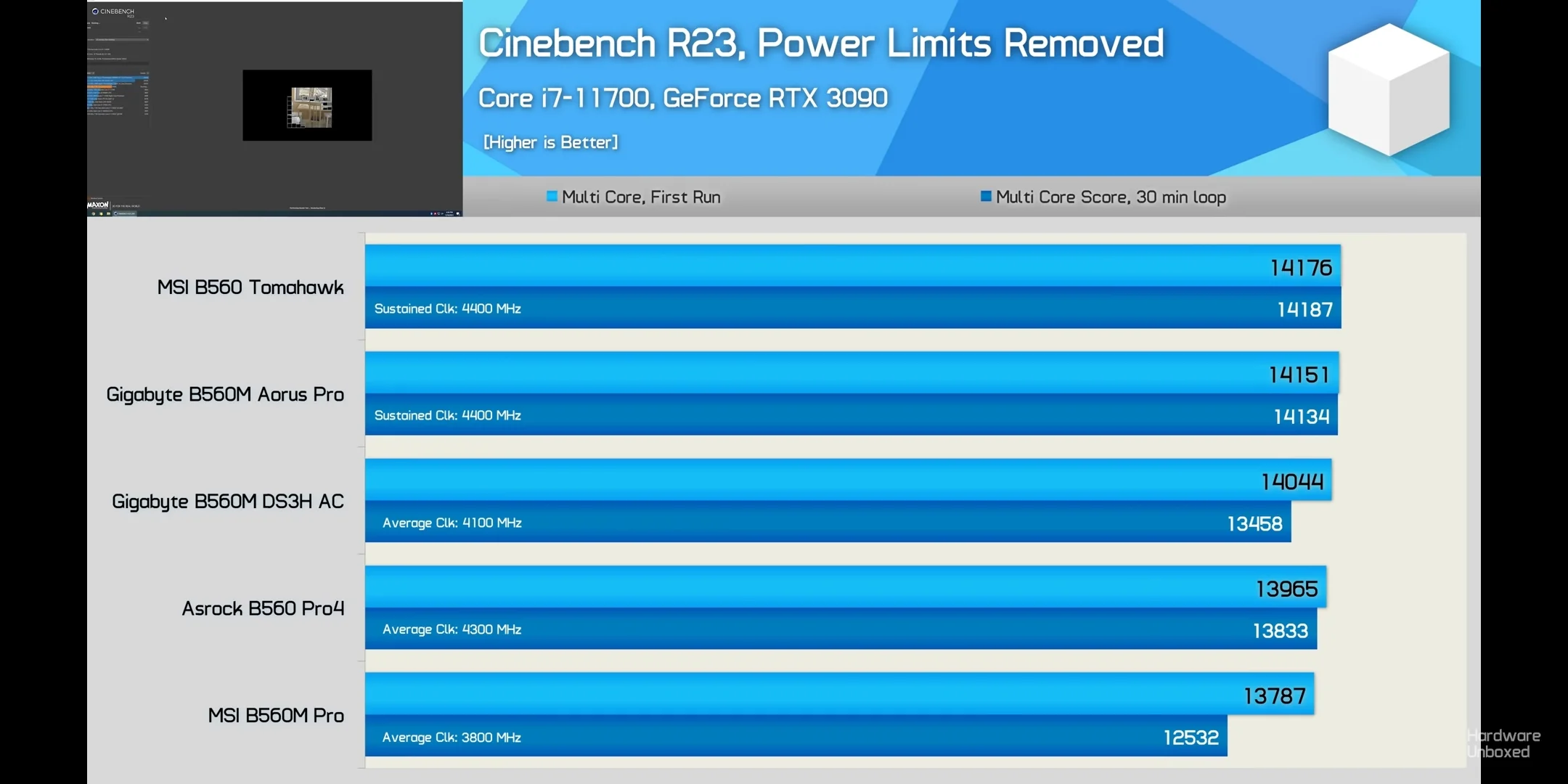

The B560 looks like an absolute mess!
The title is clickbait. The more expensive B560 motherboards break official specs by configuring TDP past spec. This has been done for years. It used to be called MCE. The cheaper motherboards will stick to spec unless you manually change settings.
Also if you look at the results of the £110 B560 PRO4 with a Core i7 11700 with MCE on,it basically only boosts 100MHZ less than the B560 Tomahawk.
They also seemingly don't include the Core i5 11400 with the TDP unlocked either so I suspect it's fine.

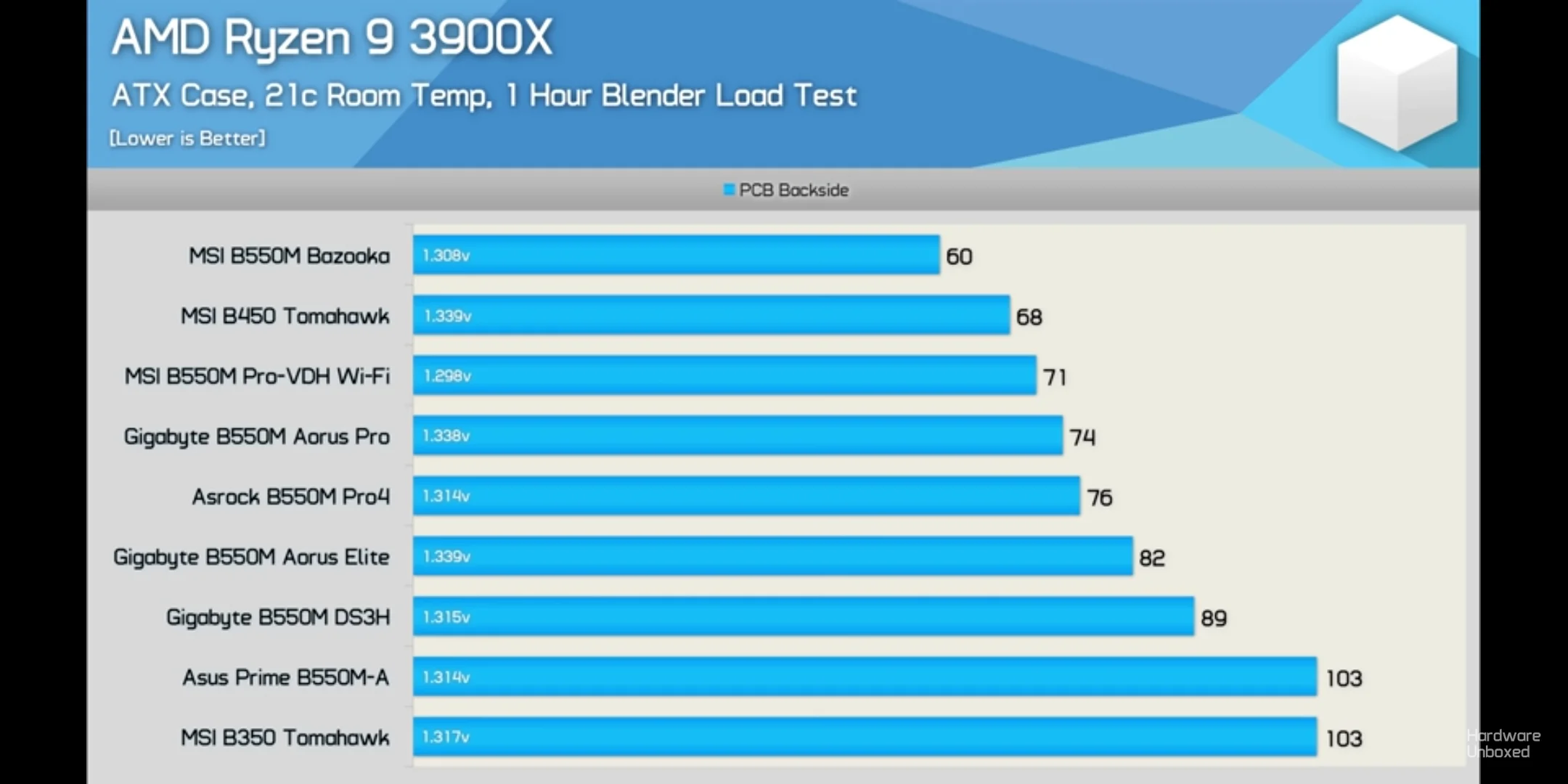

Also as Hardware Unboxed showed with their sub £110 B550 motherboards, that like that cheaper B560 motherboards the puny heatsinks lead to throttling too.
Even Optimum Tech pointed this out yonks ago with less fanfare. Also even one of the recommended B560 motherboards Hardware Unboxed suggested was the Gigabyte B560M Aorus Pro which is £125.
What a surprise Asrock have one of the if not the worst b560 boards also as shown in the video in the OP.
Its boosting 100MHZ less under heavy load than a B560 Tomahawk with a Core i7 11700. This is more to do with how the motherboards are configured at stock.
The other two have puny heatsinks and if you look at their review of the B550 motherboards there were issues with the cheaper ones too.
Plus they said the Gigabyte B560M Aorus Pro was decent. That costs £125 to £150:

I tend to look at the heatsinking - decently finned heatsinks will mean the heat can be moved off the VRM better,even if the VRM is not as overbuilt as competiting motherboards.

anyway, seems like a very good board paired with my 11700 and has none of these issues (maintains max all core clocks without any tinkering, goes up to circa 150w). It’s the same board basically as the tomahawk I think but has dual lan ports which I wanted, rather than built in WiFi.
I too think the hu video is a bit click baity. A lot of the boards will likely be ok if you spend a few mins tinkering with settings.
It would have been better presented as an informative video showing what settings need to be changed to unlock the TDP on budget boards which seem to have these turned off by default rather than the "OMG your losing 30% performance" as its only a setting just like XMP which most users are capable of entering the bios and enabling so long as they know about it.

without even listening to the video, I looked at the graphs at the start and then the ones at the end straight away thought, why did they make this video?the entire video is clickbait
The title makes it sound like you will lose 30% performance of you buy the wrong b560 board but then at the end of the video they show that's actually not the case
