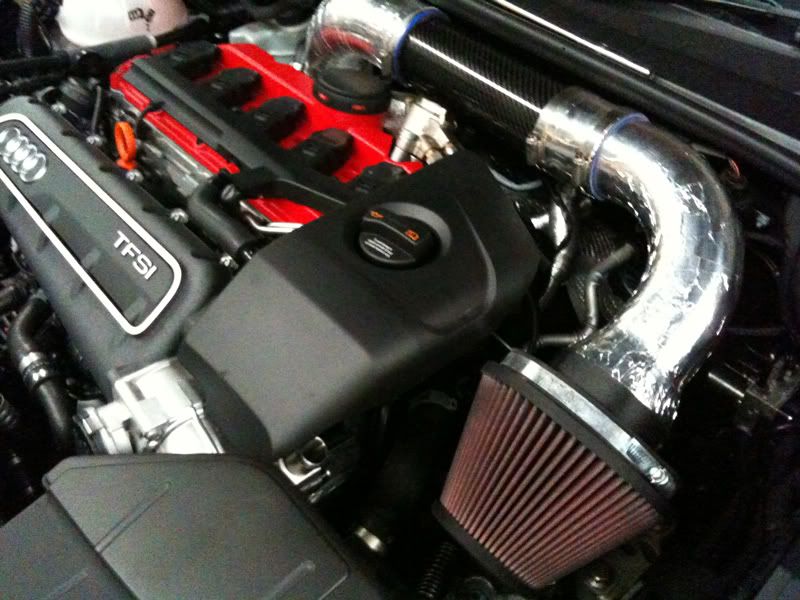

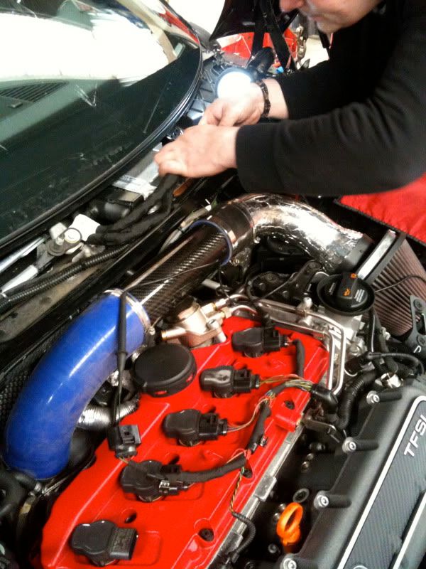

Started work with a custom carbon intake.. At the time there was nothing else available..

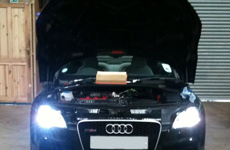

And some PIAA Xenon bulbs.. Expensive but work amazing, the quality of light is just outstanding!!

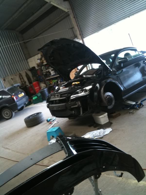

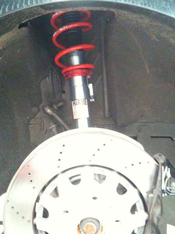

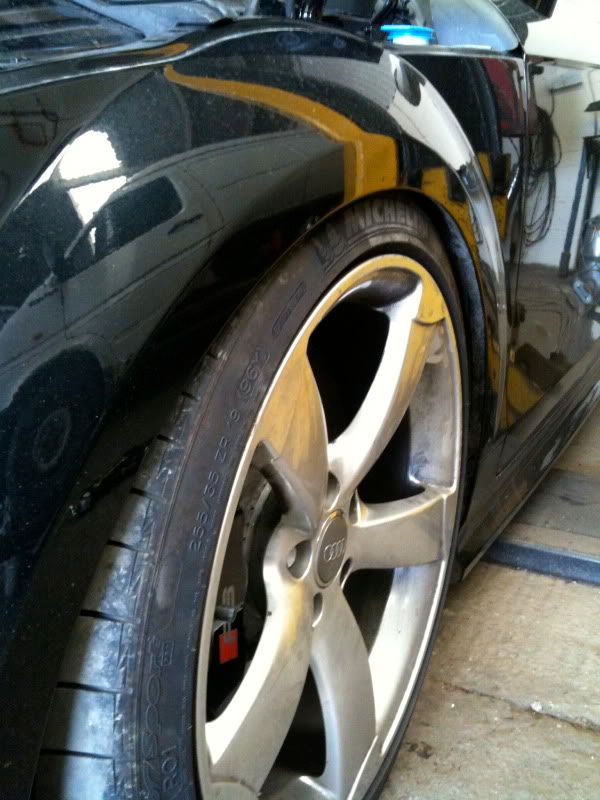

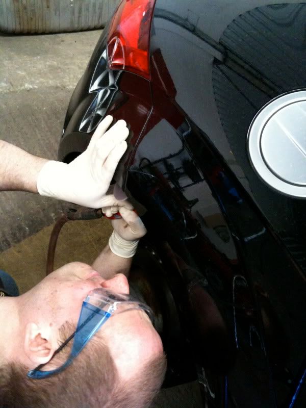

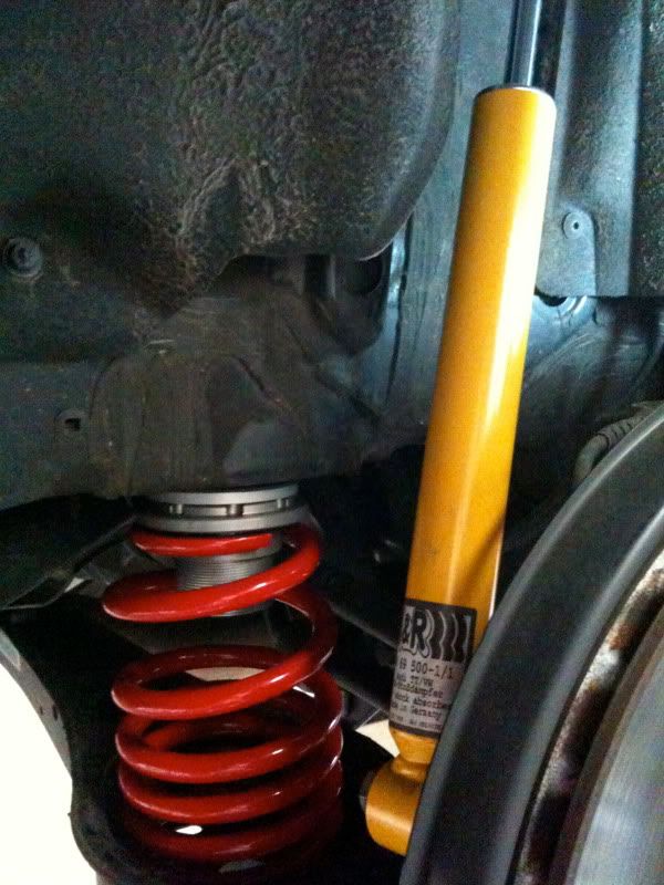

Then it was back to the appearance a little.. So time for some arch mods to make way for some H&R Coils and some 15/20mm spacers front and rear!!
Which resulted in this..

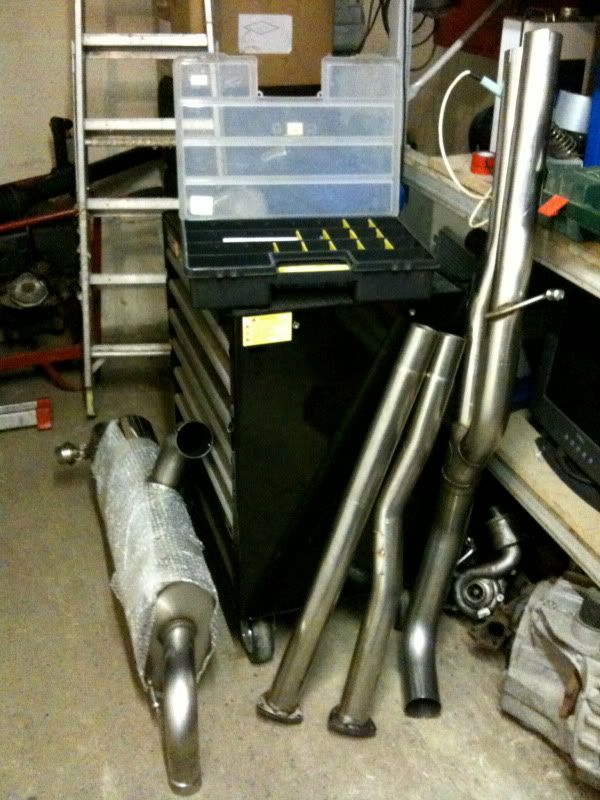

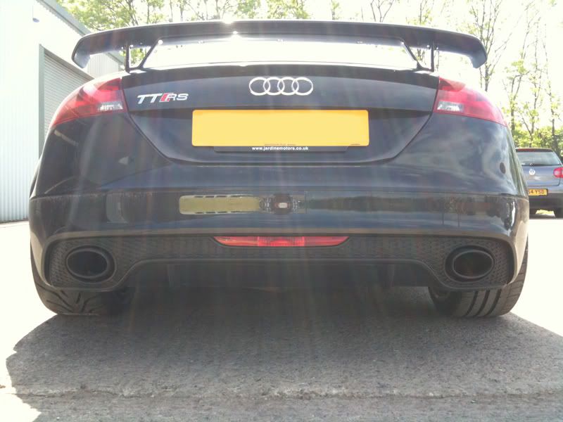

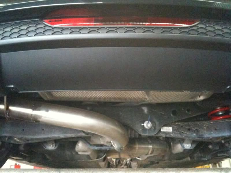

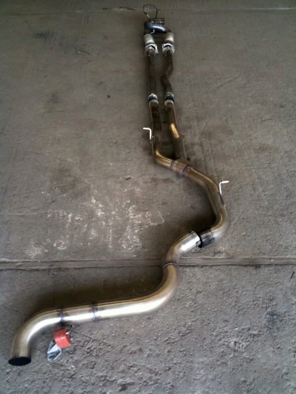

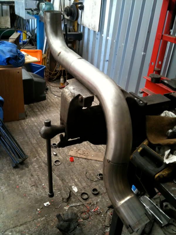

After all that, I decided that the Milltek wasn't quite doing it for me, so got some new parts
And ended up with this as a rear section!
And some comparison shots.. Spot the difference lol..

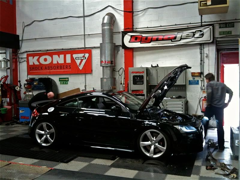

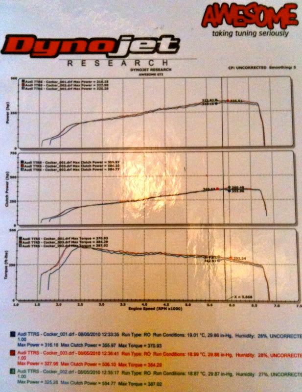

So at this point I was running with OEM software, OEM intake and Straight pipe exhaust. I then decided it was about time for a dyno to base line the car with these mods!

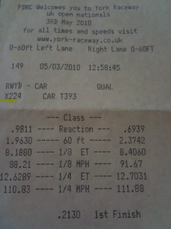

360hp / 370tq

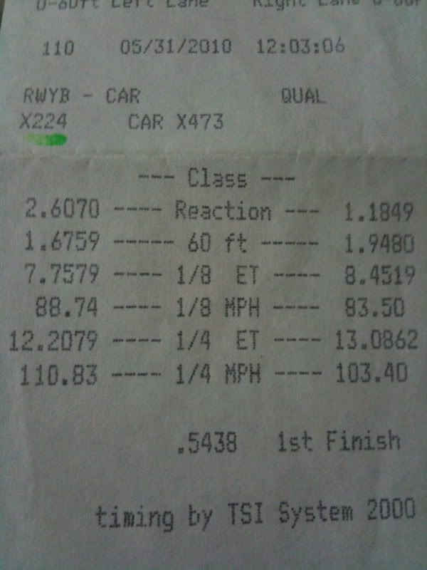

And then back it up at the track..

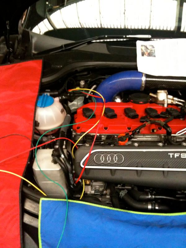

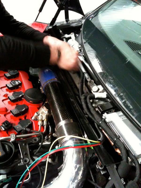

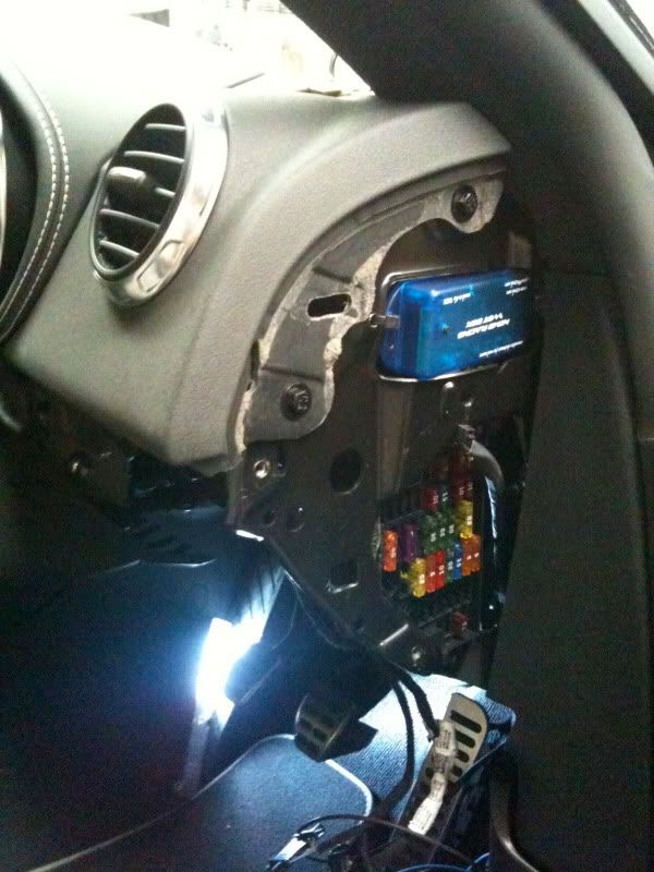

Not bad from essentialy a stock car!.. I was pretty impressed.. But needed more, and the launches could be better with the addition of a WOT Box, something that I had installed on my previous 2.0T FSI S3..
And then all hidden in the fuse panel.. Totally stealth!
Well, kind of stealth!! lol..

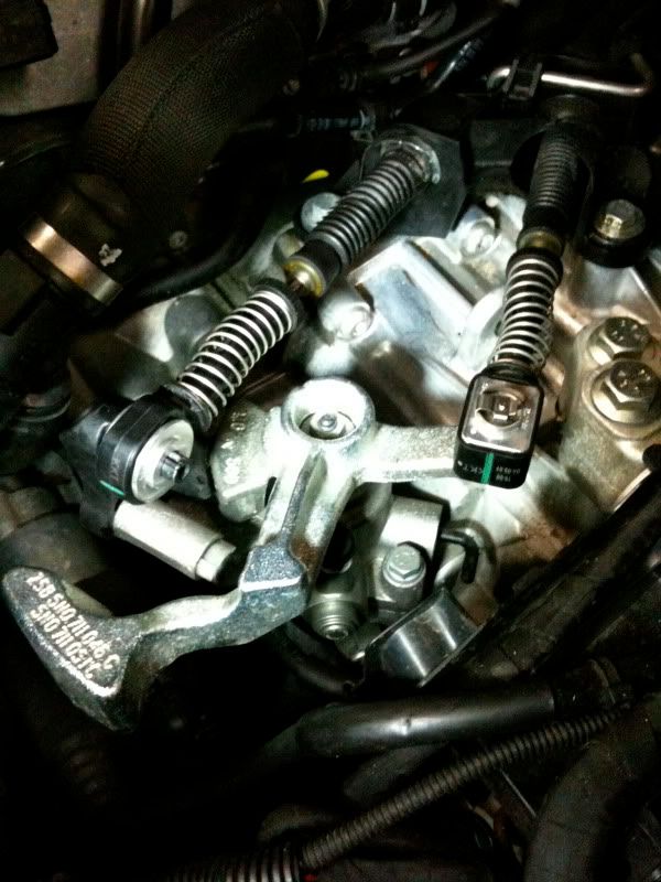

Custom solid shift bushings

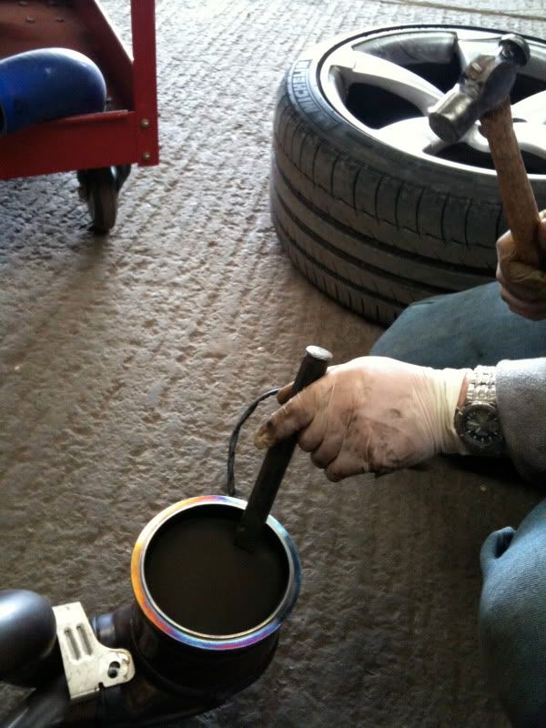

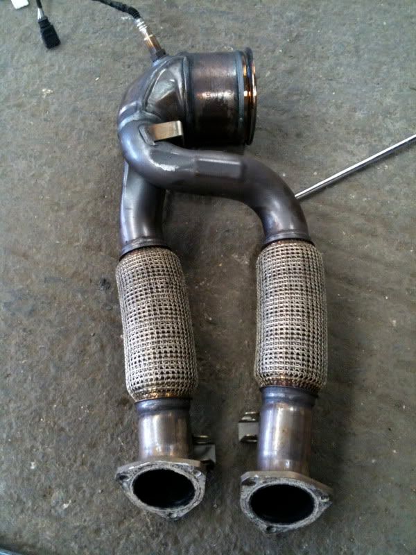

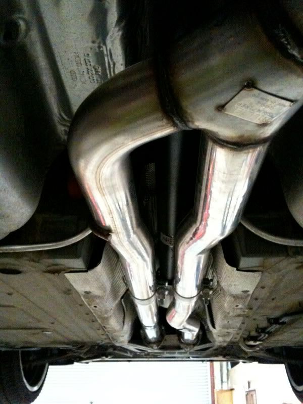

And a gutted stock Audi Downpipe..

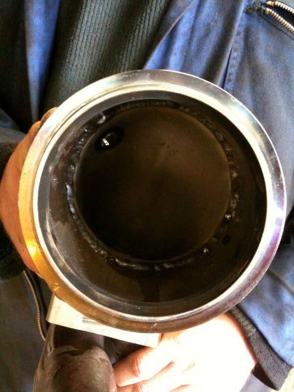

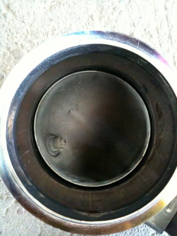

We then went on to improve a little on the flow of the stock downpipe with some extra welding work..
Before
After
Now the exhaust is totally catless, and no silencers.. Looks pretty cool, and sounded insane!!!

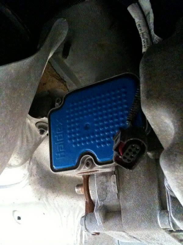

Then it was onto the Haldex.. Nice new remote Gen 4 controller installed

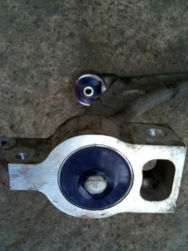

And poly bushed front end too..

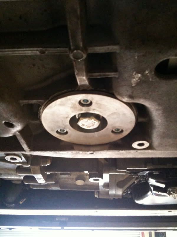

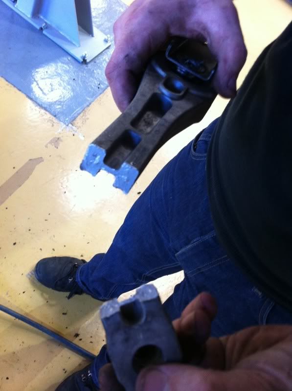

Along with a totally solid CNC lower engine mount

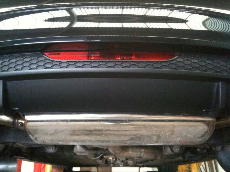

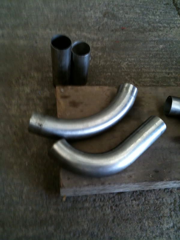

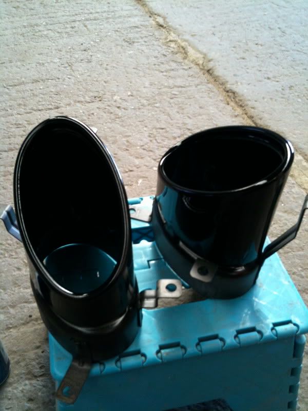

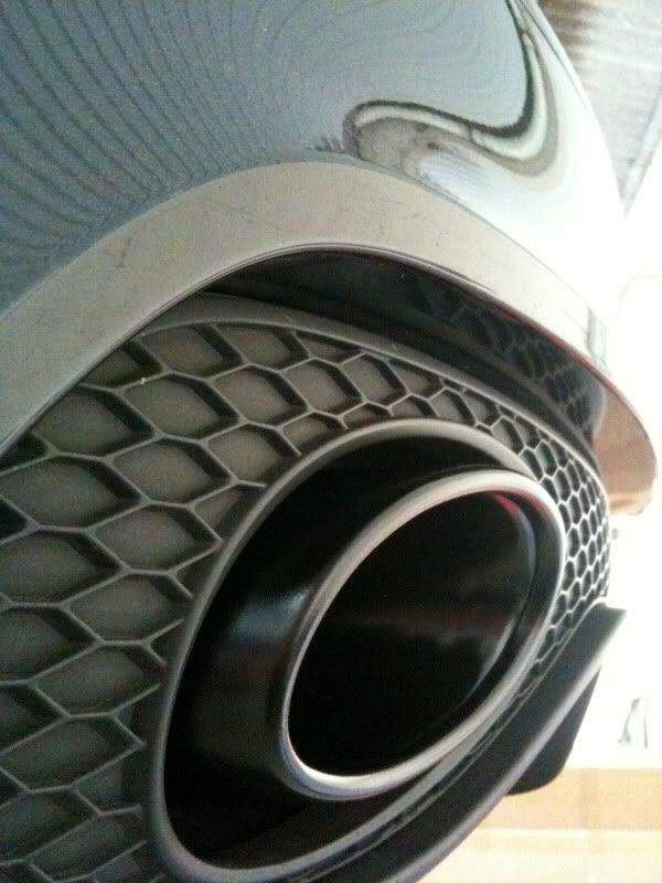

And some home made stealth tail pipes.. From Audi they cost something stupid!
After all that.. It was time to go back to the track.. Remember, still OEM software!
http://s123.photobucket.com/albums/o304 ... G_0091.mp4
So a nice little improvement over the last time.. Launch helped a lot, and the suspension and Haldex too!!

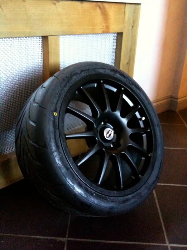

Now some new wheels and rubber!!

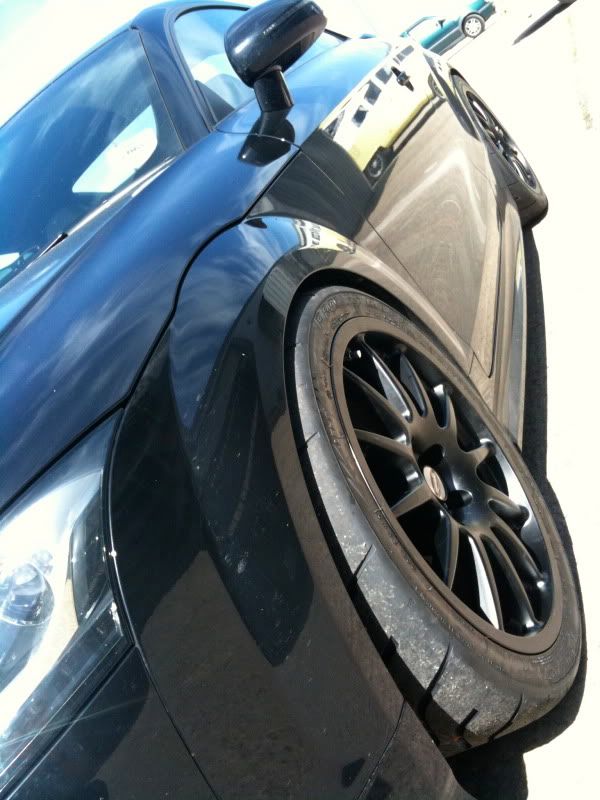

Custom made Team Dynamics Pro Race 1.3 in a 18x10 ET45 fitted with 265/35 Toyo R888's
And a comparison from stock side to side!
Now it was time to change out that abortion of an intake that I had made.. Far too much hot air being sucked into the engine bay, and with no intake available for the TTRS at that point, I went with a PiperCross filter in the stock Audi Airbox, with some little tweaks in the form of a cold air feed and heat protection..

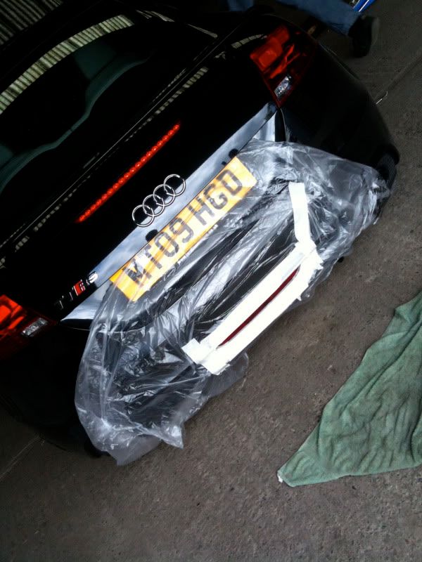

And blacked out the front and rear too..

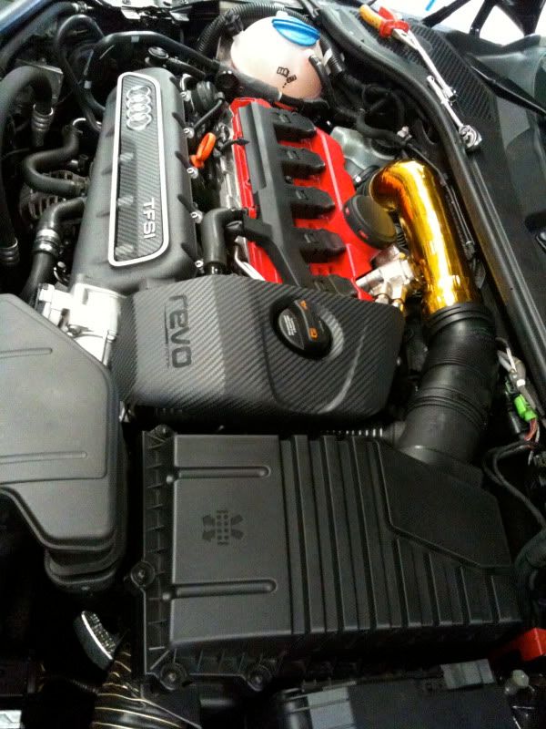

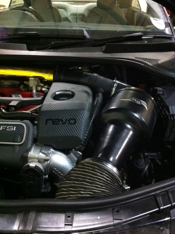

And the first prototype intake from ITG was installed..

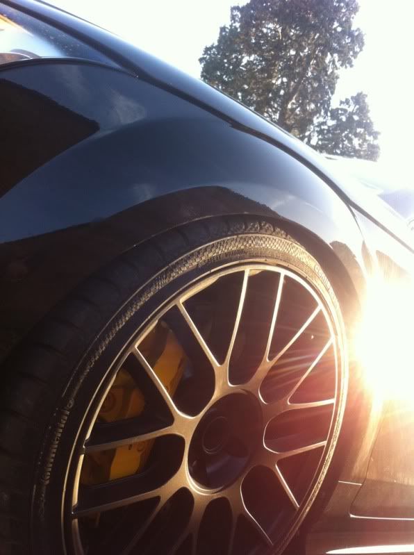

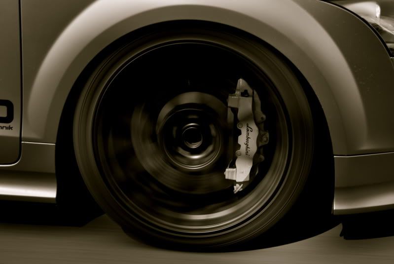

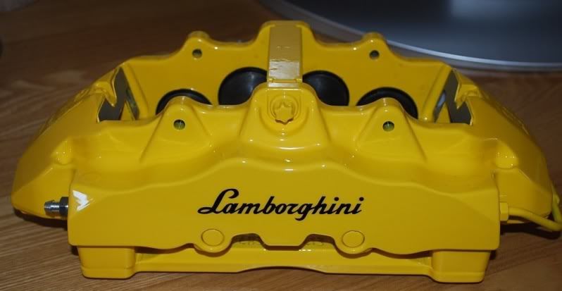

And then some tasty brakes!!!
Which also looked pretty nice on the car too

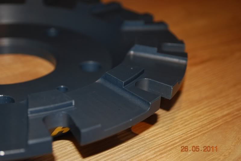

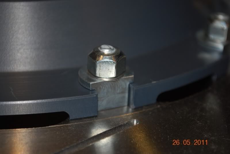

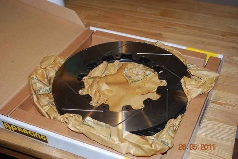

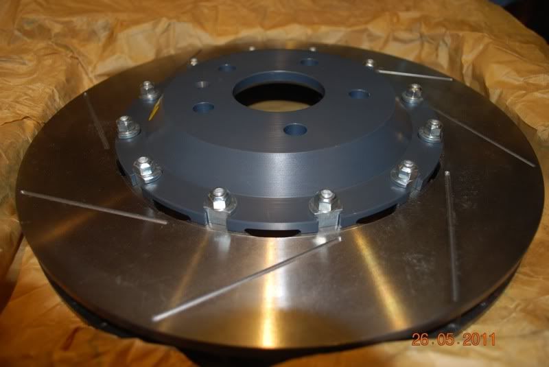

By which time the new race inspired floating discs were ready to install..

Love the wrap, but the paintwork wasn't bad enough to cover up in the first place! Made a monster out of a car which is incredible at stock anyway. The pic with the wheel's spinning so you can see the lambo brakes is sweet. Least it was done properly and not a halfords special, some thought and hard work actually went in on it.
