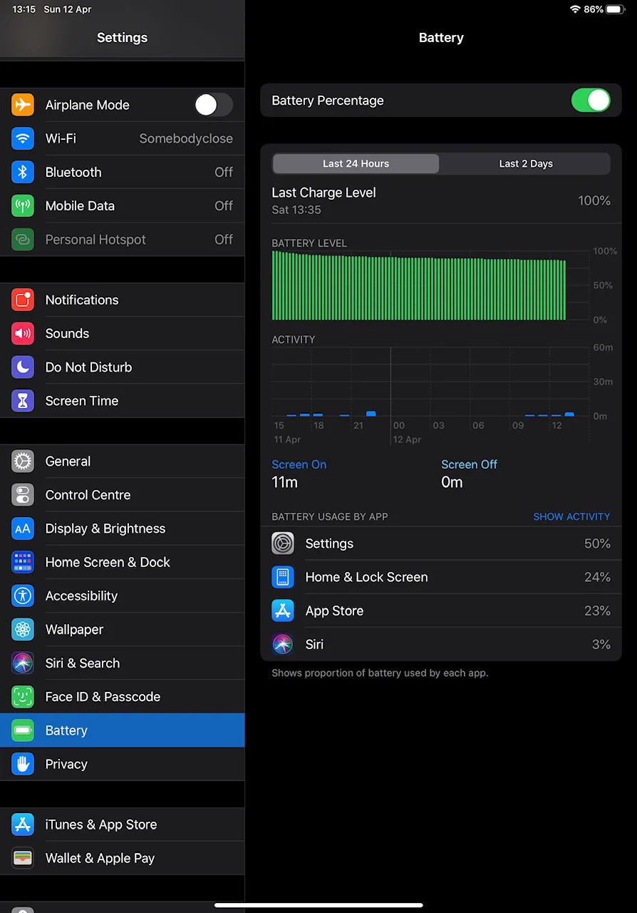

Thanks for the replies, i'm currently on chat with them now but heres my graph
Somethings not right there. I would ask them where on the graph the battery shows in MRI diagnostics .. if it looks normal then possibly something else wrong, although they are right restoring via iTunes is the next step
