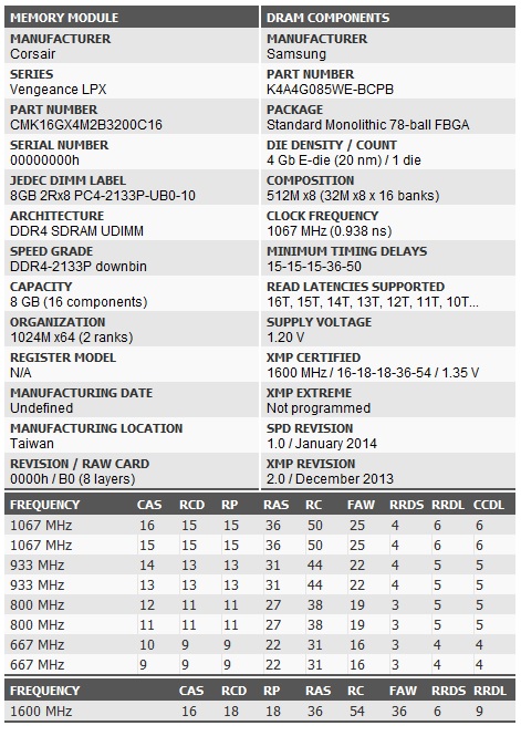

Is there a program that you can run which informs you what the memory chips are on your currently installed RAM...?

Learning everyday, good to know, thanksYes there is, thaipoon burner, it's free too
