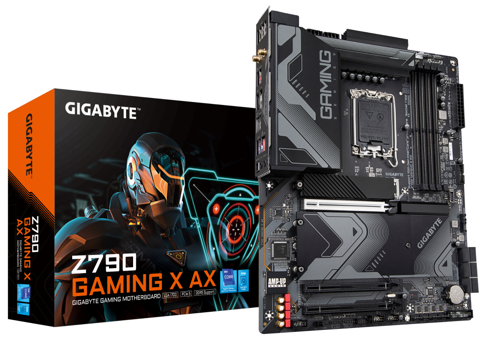

Firstly, a little background.
Around 9 months ago I decided to upgrade to the following :-
Following the build I had issues with games crashing, BF2042 wouldnt play unless I slowed down the CPU, Forza H5 and Wolfenstein TNC would crash randomly.

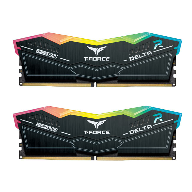

Memtest revealed multiple errors so I spoke to OCCS and they recommended that the ram was too fast for the board and on their advice I downgraded to :-
I also later in the year changed the motherboard to this one I picked up from the MM :-
And added an extra:-

The initial 7600 ram kit when running under XMP, Memtest gave multiple errors but with XMP disabled gave 0 errors.
I changed to the Asus MB purely because I've always used them in the past, but was unable to justify the cost until one came up on the MM, not because I suspected issues were with the Gigabyte MB.
I dont think airflow is an issue as I have 3 extract and 2 supply fans and system / gpu temps seem to be normal.
Following the suggestions made after my initial post I have tried the following :-
Removed the later set of RAM and turned off XMP, Memtest has returned 0 errors.
