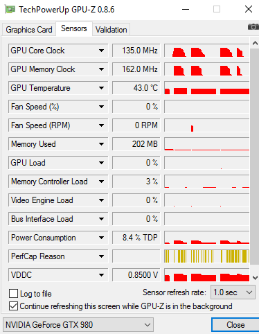

GPU sits at 135mhz and 162mhz then suddenly shoots up to 1752mhz and then I get the display has stopped and recovered.
I'm using dispayport to a Gsyn monitor if that helps.
Here you can see where its recovering.
