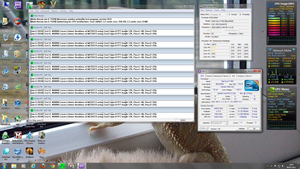

Hey all,
Just overclocked my i7 950 to 4ghz. Its stable on prime for an hour no problems (its all i tested for) and stable for gaming for 3-4 days, few hours each time. Idle temps when just internet browsing are around 44c, gaming is around 65c and prime settles at around 84c. Does that sound about right?

if its stable its a good oc regarding cpu voltage,test with 10 runs on high with intel burn test,if it passes that then you can say its pretty stable,no more than ten runs though as its very stressful,and dont let core temps go above 80c imo but 84c for very very short spikes is ok
Games will run a lot lower than prime/ibt etc. I see a max of 77c under ibt, 64c max with bf3.
Just done the intel burn test on high with 10 runs. It did it fine, but did hit 89c on 1 of the cores for a second. Looking at getting a new CPU cooler, quite like the new Frio.

Temps aren't too bad, as suggested above probably could do with an additional case fan or go to a push/pull config. That's a good vcore for 4GHz too. My i7 920 @4.0 peaks at 72c during IBT with Thermalright Silver and a Fractal R3 which is a pretty poor air cooling case, so adding a couple of fans to your setup should help.
