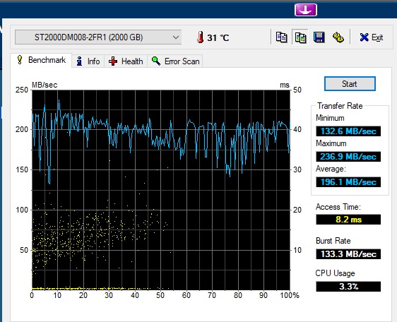

Is this a primary or secondary drive? Try downloading and installing HD Tune (non-Pro, regular version) and leave it running permanently (tray icon) and report back if it fixes the problem.
HD Tune: ST2000DM008-2FR1 Benchmark
Transfer Rate Minimum : 132.6 MB/sec
Transfer Rate Maximum : 236.9 MB/sec
Transfer Rate Average : 196.1 MB/sec
Access Time : 8.2 ms
Burst Rate : 133.3 MB/sec
CPU Usage : 3.3%
For clarity: the reason I said leave it running as a tray icon is because it can temporarily (while the program is running) disable parking/sleep on my drives and that stops the clicking and power down/up. It doesn't need to be doing anything, so no need to run the benchmark or scan.
