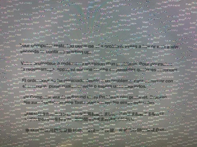

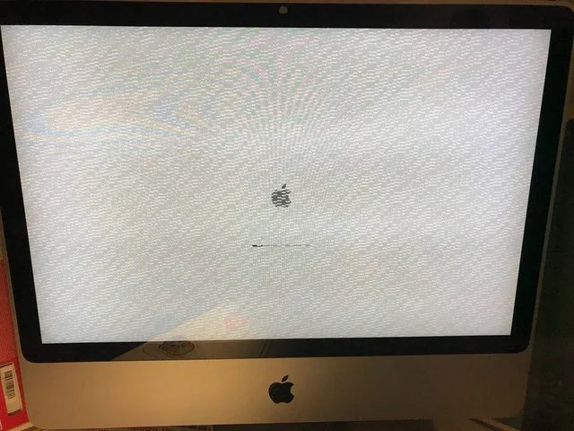

Hi,
Our 2009 24" iMac has taken a turn for the worse. The screen is showing constant graphical corruption and it won't start up properly, displaying a message "Your computer restarted because of a problem. Press a key or wait a few seconds to continue starting up.", it then restarts and goes into a loop.
I'm pretty sure the graphical corruption came first and it was only after attempting a few power downs and restarts that it developed the error message and went into the loop.
Any suggestions of things to try? Thinking the logic board could be borked?
