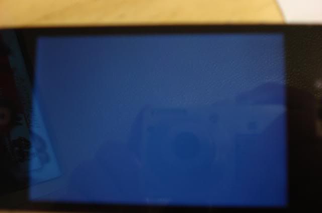

Just replaced an iphone 4s screen and just see a dim display when switch on, no apple logo either.
Is it a faulty screen do you think?

It is a faulty IC chip connected to the lcd cable on the digitiser.
It's the rectangular hard thing on the cable. Either it came damaged or you damaged it by bending in the wrong place when fitting.
Hi thanks for that, so, is that the wee sliver thing?
Nothings impossible but almost sure I didn't damage it.
I've replaced 20 or so screens and always careful.
Thanks V much for the info.
Probably needs to be returned and nothing to do with you then.
