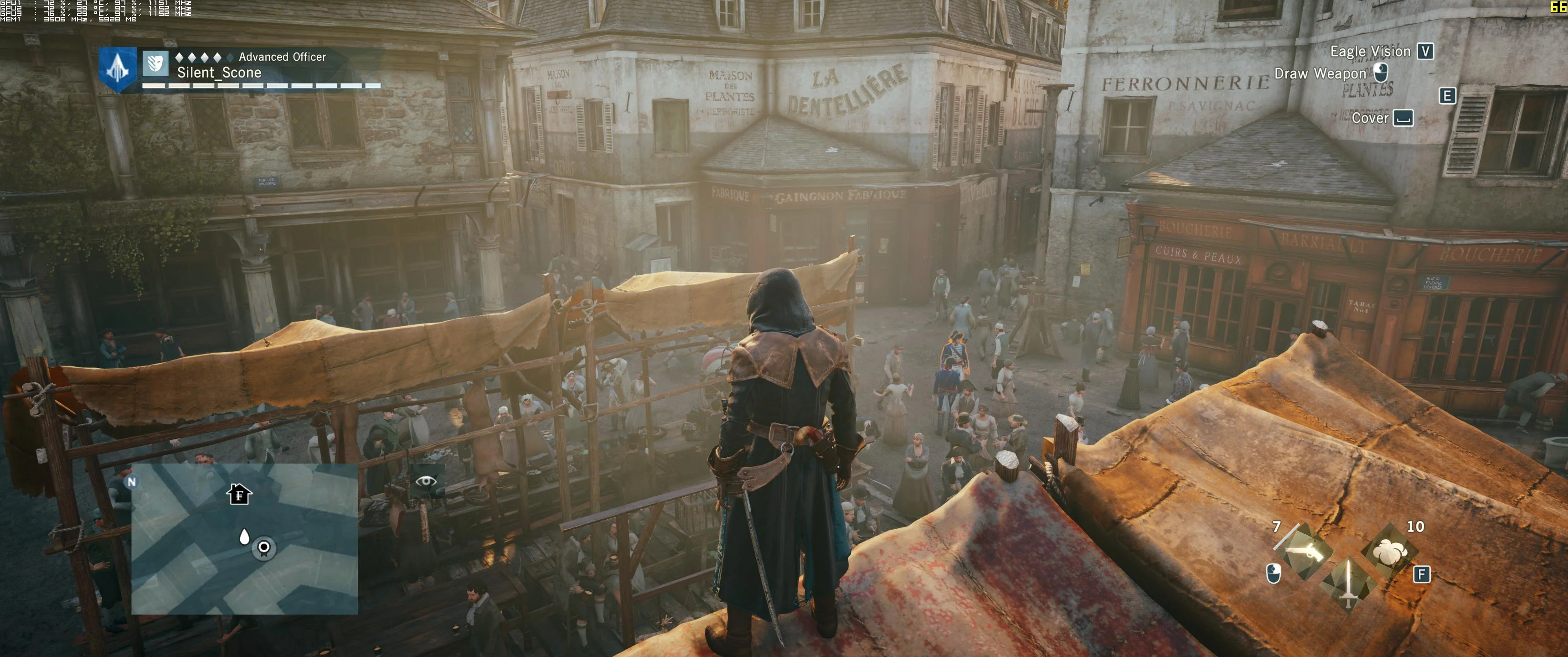

Alright guys, just been playing around in AC Unity and noticed its choppy in places so i decided to look at what my system is doing. You may not be able to see too well from the pic below but the stats are as follow
GPU usage: 67%
GPU Temp: 66 degrees
GPU Mhz: 1031 (max speed is 1150Mhz)
D3D11/FPS is: 42.6 (averages around 45 in busy places such as in the pic)
CPU1: 58%
CPU2: 69%
CPU3: 61%
CPU4: 72%
And as you can see from the stats there is not full utilization, so im asking my self why this is and i cannot understand why. So i'm currently considering it to just be the game with it being poorly optimized? Surely with the cpu not at 100% or near that at any core its not a CPU bottleneck?
Anyway running
i5 3750k 4.4Ghz
290x at 1150Mhz Core and 1500Mhz Mem
Seasonic 750w 80 Plus Gold PSU
System should handle this game fine right?
Cheers guys.
