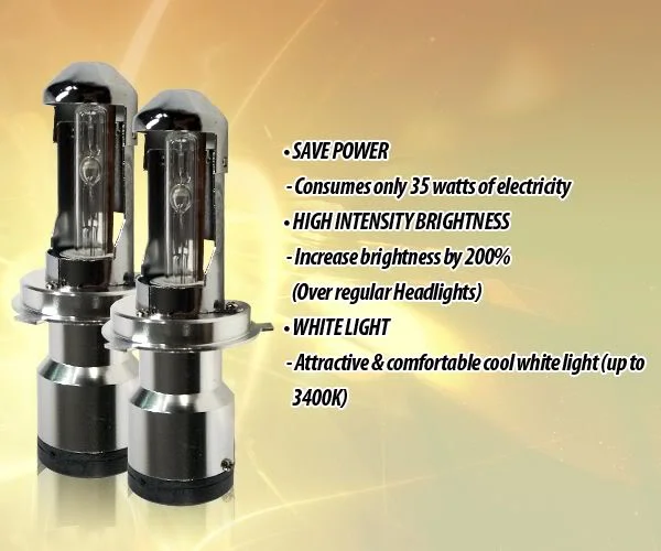

They have a metal shield which I'm guessing is to prevent dazzling...

They also can't be your bulbs, they are a reasonable 3400k, you've already admitted to having a blue 6000k.
Ones I got are these:
http://www.ebay.co.uk/itm/301882915...49&var=600694338120&ssPageName=STRK:MEBIDX:IT
Then why bother? Just buy some good quality osram / phillips +100% halogens and actually get a decent bulb that casts some usable light instead of joining the ever increasing number of people that like to scatter rubbish blue light everywhere but where it's needed.
Are those the best type I can get? What about going for LEDs?
Then you still didn't get the bulb type you posted above, they are H4 (also available as in your eBay link), which your Focus won't fit. You'll have the H7s which aren't a bi-xenon lamp, so no built in reflector.
