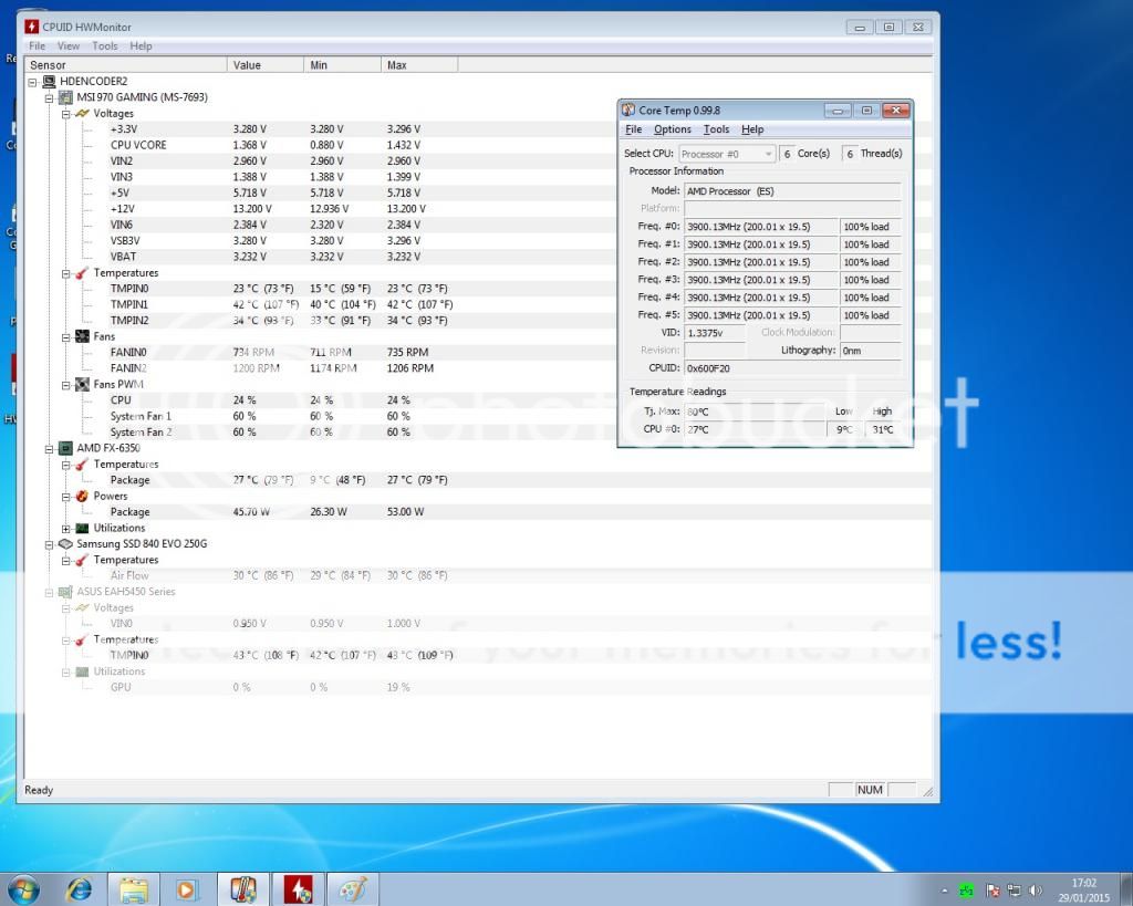

Due to popular demand i have uploaded two screenshots, apologies if not clear i can sort that out if it is a issue, please remember that the MB and chip are running stock "Optimized" settings.
Idle
Stressed
Thank you for all the advise
CitizenX
Thankyou and yeah it all does look fine, vdroop is 1.368v which is more than enough.
Usually a handler failing in p95 is lack of voltage or heat.
Ram voltage and timings, command rate i take it are stock too?

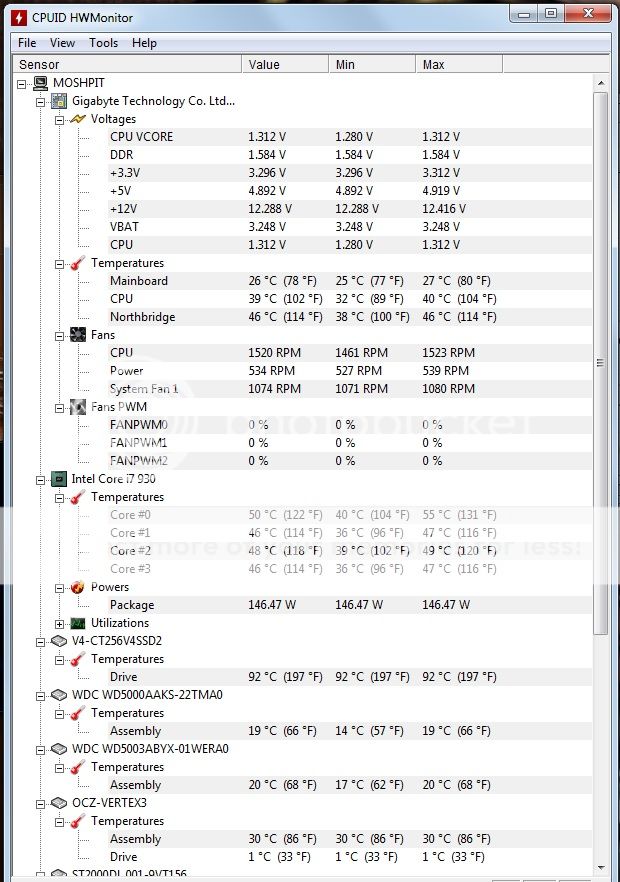

I was wondering if i could ask a cheeky favor, I have my main rig that I have OC'd many moons ago, it has been up and running for almost 5 years and just winged it by reading some posts online but i was wondering if I could run it past you to see if i could improve it.
its a i7 930 that used to be able to be clocked to 4ghz but of late is unable to stay stable, at some point in its life it crashed and lost the OCUK profile and as mentioned I winged it
Below is the HWmonitor screenshot, could you kindly have a look and advise if anything is out of place?
its running at 3.96 (180X22) stable maxing out at 57 degrees but perhaps with a few tweaks i could get it back to its 4ghz glory :)
Thank you again for all the help
CitizenX
For the 930, the hwmon shows great temps and voltage is good, but maybe needs a bump to 1.31v-1.35v
What gigabyte board is it?
Could you provide the firsr screen print of cpu-z, also including the memory and speed sections from cpu-z.
What is the qpi-vtt voltage set to in the bios,and how many sticks of ram do you have installed,?
It either needs a couple of bumps up on the v-core, or/aswell a bump up on the vtt voltage to 1.3(1.35) max

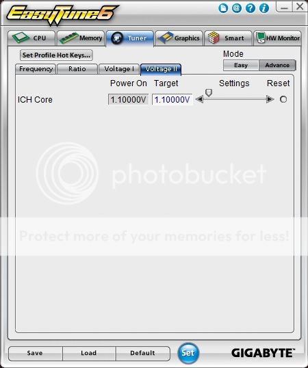

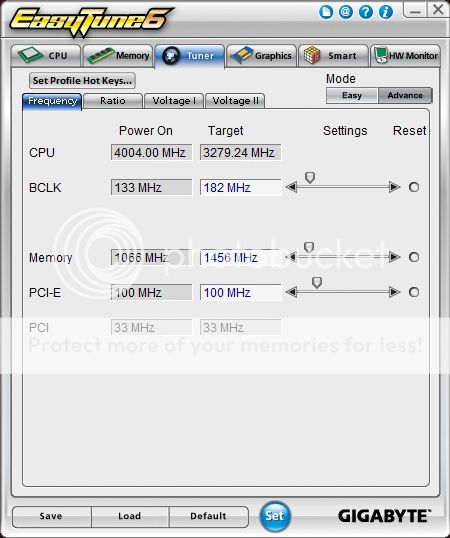

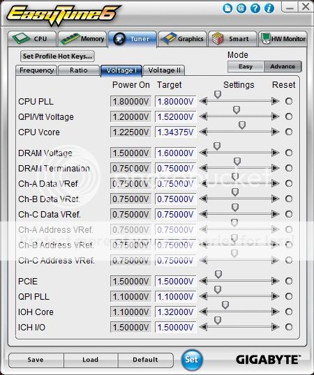

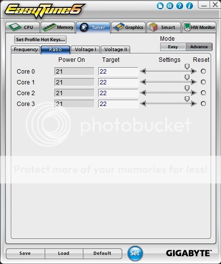

Gentlemen, thank you again for all the help please find below a boring bunch of pics, now i know it may not be ideal but it may help tweak my settings and I am happy to change the in the BIOS.
I have updated the bios which gave me a heart attack and killed my raid but got it back up :)
So I bravely bumped my CPU to 4GHZ and put it under some strain please find some screenshots below and advise or ask for some more info
Temps and volts
Hopefully some relative info:
Please let me know if there is any advice you may provide :)
Again many thanks
CitizenX
