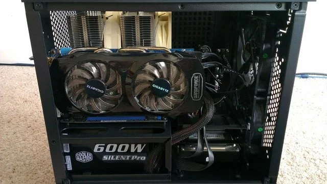

As per the others, the fact hat the build is dwarfed by the cooler put a smile on my little face.
I've not looked at m-ITX since my Zotac Z68 board, which I sold, but this from Asus looks a real beast. I'm loving the VRM's mounted on a daughter board. Is that actually fixed into the main board, or does it unclip so it's an optional install? All the pictures I've seen have it already in situe so I'm guessing it's actually mounted.
Not tempted by going down the close loop water cooling route to save some space?

The daughter board looks like you could take it off, there is a screw either end and a connector to the motherboard.
Nah I like my Noctua too much to try water cooling, partly why I got this case as it can fit my cooler :)

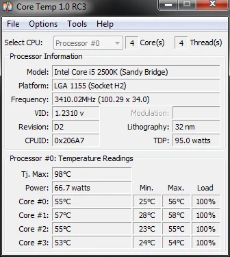

On the lowest setting on my fan controller it was idling at around 32, my room is quite warm though. I'm afraid I really haven't much time with it. Getting married next year so planning for that has taken over slightly!
Managed to do a little test today, 20 minutes of prime on my lowest fan setting saw it hit a max of 58C
On the highest fan setting it hit a max of 50 after ~20mins.
Pretty happy with that as its very quiet on low. This is at stock settings.
Nice build. Wanted to ask if you can have a DVD drive installed and still fit in the Noctua d14? (with the first fan removed from the d14)
Eye-balling it, it looks OK but would be great if you could let me know for sure.
Thank you!
I don't actually have a dvd drive to test but the tray itself will just about fit even with the front fan on so a dvd drive should fit without that fan. Hope that helps.
