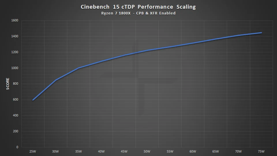

You don't necessarily need to go laptop, but you do need to do proper research especially into the parts' efficiency curve. Even a Threadripper + Radeon VII isn't going to be 700w unless you just push voltage insanely. Tbh, definitely wait for Zen 2 & Navi, that's just a no brainer, first of all. Secondly, going a laptop isn't going to help, this is a mistaken impression some people have but haven't thought it through. The reason why should be obvious: you're going to do the same work. Laptops don't have special parts which can do these tasks any better or with greater efficiency than desktop, they're simply compact. Whatever "efficiency" laptops have are simply due to the parts being used only at (or near) the optimal frequency in order to maximize performance/watt, something which can be easily tweaked on PC. At the end of the day, a laptop is just a PC with a battery, not essentially different other than that.
First of all, you gotta figure out what programs you're using and which parts are the best with those programs, and if need be which ones you need to prioritise. The performance/watt will look very different from vendor to vendor based on the program.
Second of all, you gotta ask yourself why it is you need something as powerful as a threadripper, especially now that you've been convinced to switch to laptop. That leads me to believe you don't really need a Threadripper or you don't really know. If you don't actually need a Threadripper that would be great, because cooling a threadripper is more complicated in small builds than the usual AM4 suspects.
Lastly, figure out exactly what space you need/want for a case, because itx builds vary GREATLY in dimensions, and when you're space constrained you need to know exactly what you're going for in order to plan out such a build.
Overall, I'd say you have to properly lay out your requirements & constraints and think them through. Once you have that done, it will be very simple to plan out a build.
Here's what I mean when I'm talking about effiency:

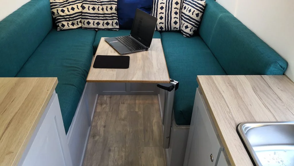

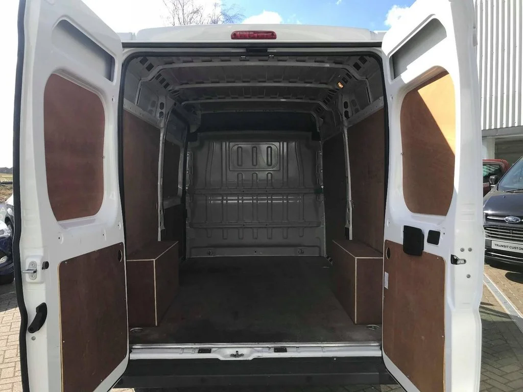

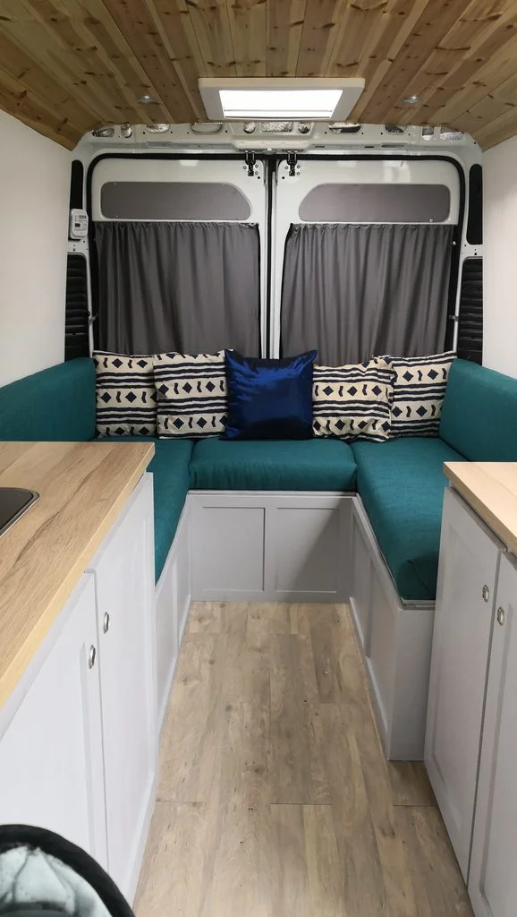

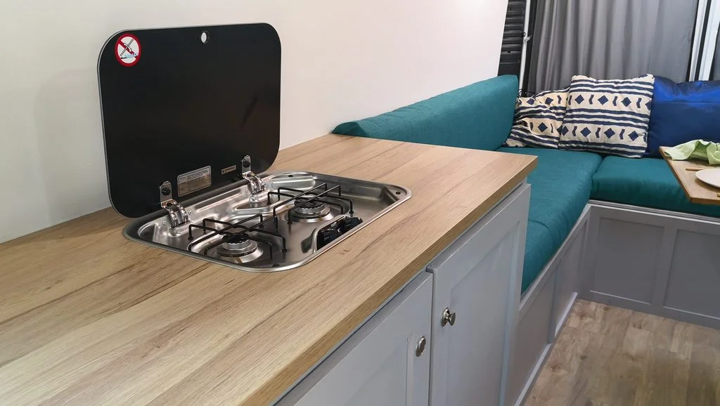

Pics,
Started with this.
Then I ended up with this.... all hand built by me.
Pics are some of the ones sent to the DVLA to get it changed from van to "motor Caravan"
Laptop :)
Last one. made all the cabinet and even the cushions a first for me.
Battery is easy enough to sort out. Or well, it's complicated, but doable. Too many variables to get into it without them being spelled out (location, budget, requirements etc). Nonetheless, PCs these days can be incredibly power efficient and running them even in a camper van off of batteries isn't that far off from a laptop. After all, if you're doing any kind of work that battery is going to be gone quick, so either way you'd want to sort out the energy storage unless you want to only do 1-2hrs a day of work. Remember, the work hasn't changed & the parts are not any more efficient, there's only so much you can do with a <99 Whr battery.
For example, this system if properly tuned for optimal efficiency would not require more than 250ish watts IF it was all equally and fully stressed, which is never really going to happen. So realistically you'd be looking at <200w for an absolute powerhouse. Obviously, the 2080 ti is overkill and can be changed easily for another turing gpu, but it is the most efficient GPU once properly undervolted, so there's that.

Wow, looks really well done. What van is that? There's going to be 5 of us in mine (myself, wife and 3 kids which are home educated) so guess I'm going to be looking for something quite big unless I can sort it like an itx build lol
