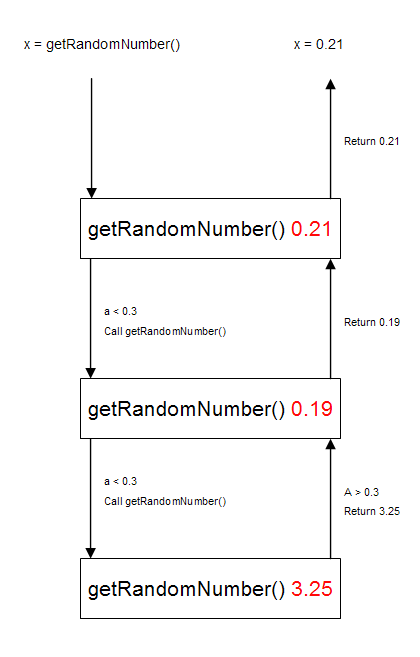

Hi guys,
Being really thick here...
I'm trying to generate a random number between 0.3 and 1.
I have written the following basic code, but can't work out why it's not working (It's returning numbers <=0.3)!
Code:
public class Random
    private double x;
    public Random()
        for(int i=0; i<10; i++){
            x=getRandomNumber();
            System.out.println(x);
    public double getRandomNumber()
        double a;
        a=(Math.random());
        if(a<=0.3) {
            getRandomNumber();
        return a;
Any help appreciated, cheers.
Change it to return getRandomNumber(); in your getRandomNumber() function and it will work. Pretty retarded method of doing it since your having to recalculate it each time times its not what you want. Though guess your not bothered about performance.
You had a recursive call to getRandomNumber() so unless by chance the first number that was generated by the call was > 0.3 you will always be making another call to the same method (recursive call). When you 'return' from a recursive call the return goes back to whoever called it, so in your case it was the method and not the constructor so you had a very slim chance of ever getting the correct numbers. This diagram might help explain:
This should work, no more recursive calls:

ah, thanks a lot mate, knew it was something so silly! just couldn't get my head around it. diagram was a massive help, thanks a lot for taking the time to do that.
