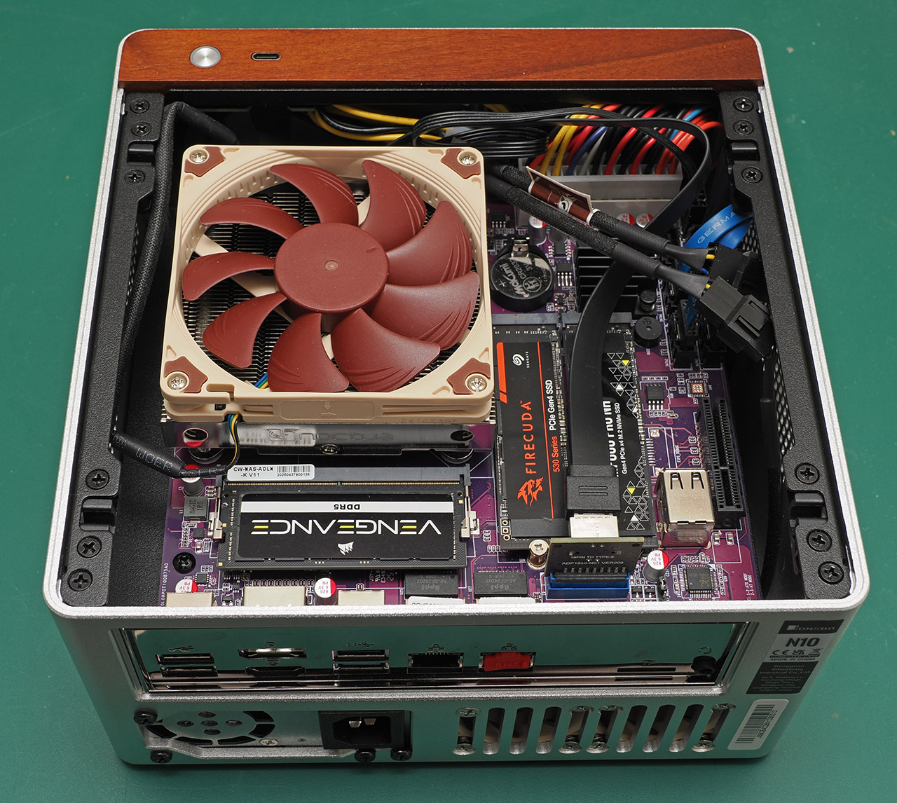

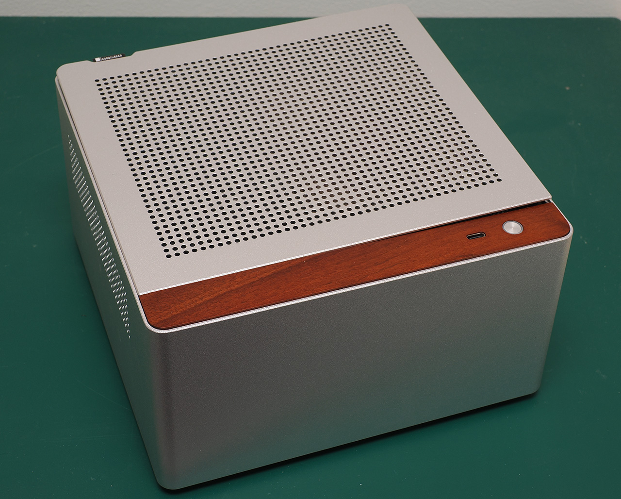

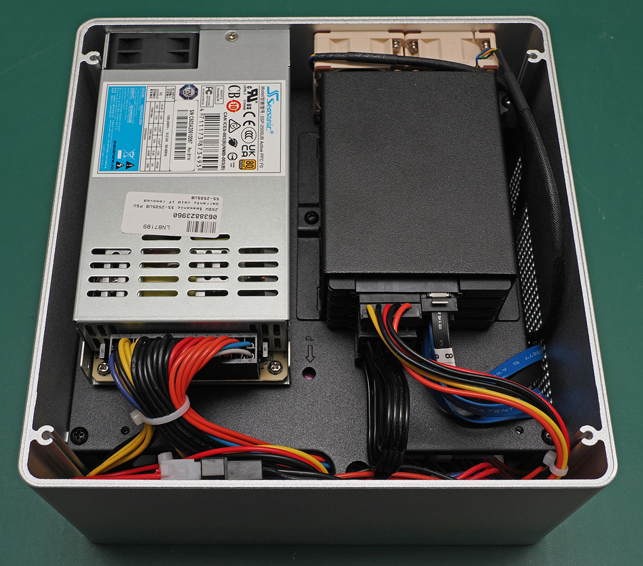

I don't know if anyone else has found this little case as it doesn't seem to be widely available. I wasn't sure if it belonged here or in the SFF section but decided on here as it's in Jonsbo's N series. I was looking for a small case for a CWWK N355 board so thought it was worth trying. It's very solidly made and remarkably heavy once populated. I used what SSDs I had in stock so there are four 4TB WD SA500s in the drive cage. I replaced the two supplied 3-pin 40mm fans with 4-pin Noctua units blowing into the drive cage instead of sucking through it. My problem now is what to do with it.....
