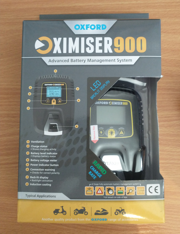

Ordered a new battery charger as I needed a new one and then I know it's working and not the battery.

I think it was my 30ish-year-old charger not doing the job lol
It was given to me used when I got my first bike 16 years ago now.
I charged the battery for an hour and it started fine, so going to leave it now to fully charge and see what happens later.
Thank you.
Out with the old
In with the new... I should got a new one years ago lol.
