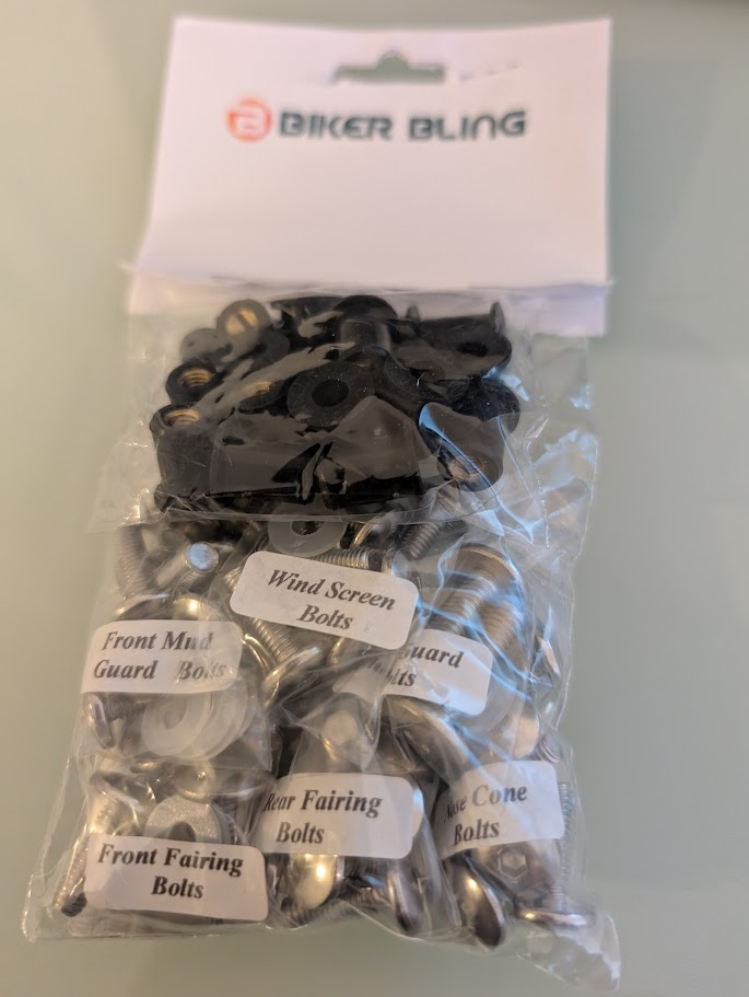

Good quality kit from those guys, I had the set on my blackbird and have used a couple of other random fittings on other bikes
Impressed doesn't quite cut it, I wasn't expecting to get each set of screws in their own little marked up bag, this is bloody fantastic!

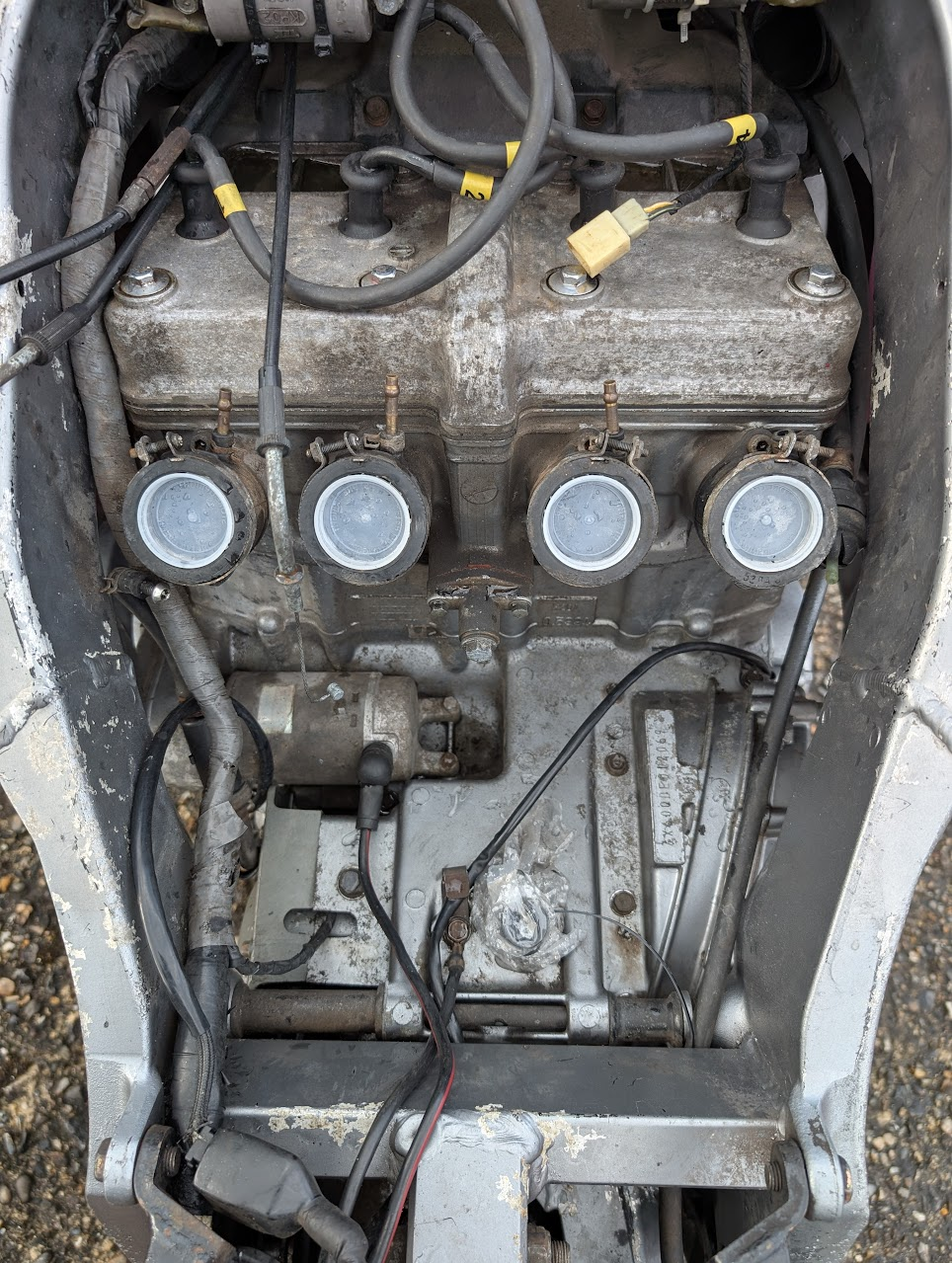

Will likely be stripping the carbs down and doing the valves this weekend, weather permitting. Saturday's pretty booked up but Sunday I should have some time to play :D

Yep they're so much better than a lot of the really expensive places.
For the blackbird they even recreated the completely custom heads on the bolts so it was like for like, whereas probolt were charging 3x the amount and you just got standard pan head bolts.

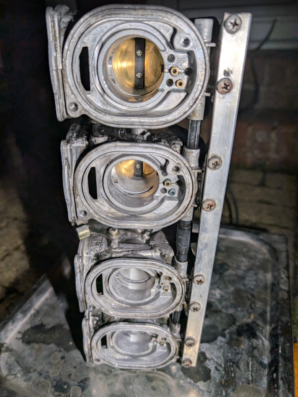

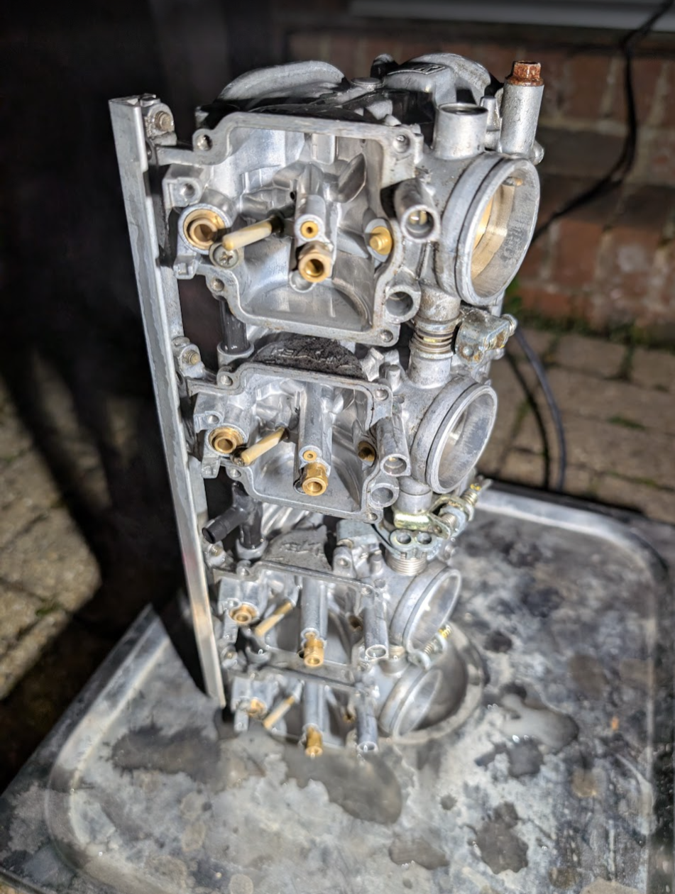

Didn't have much time today but had to do something! Started stripping the carbs and gave them a good clean in an ultrasonic cleaner leant to me by @bloodiedathame
Before stripping and checking fit in the cleaner:

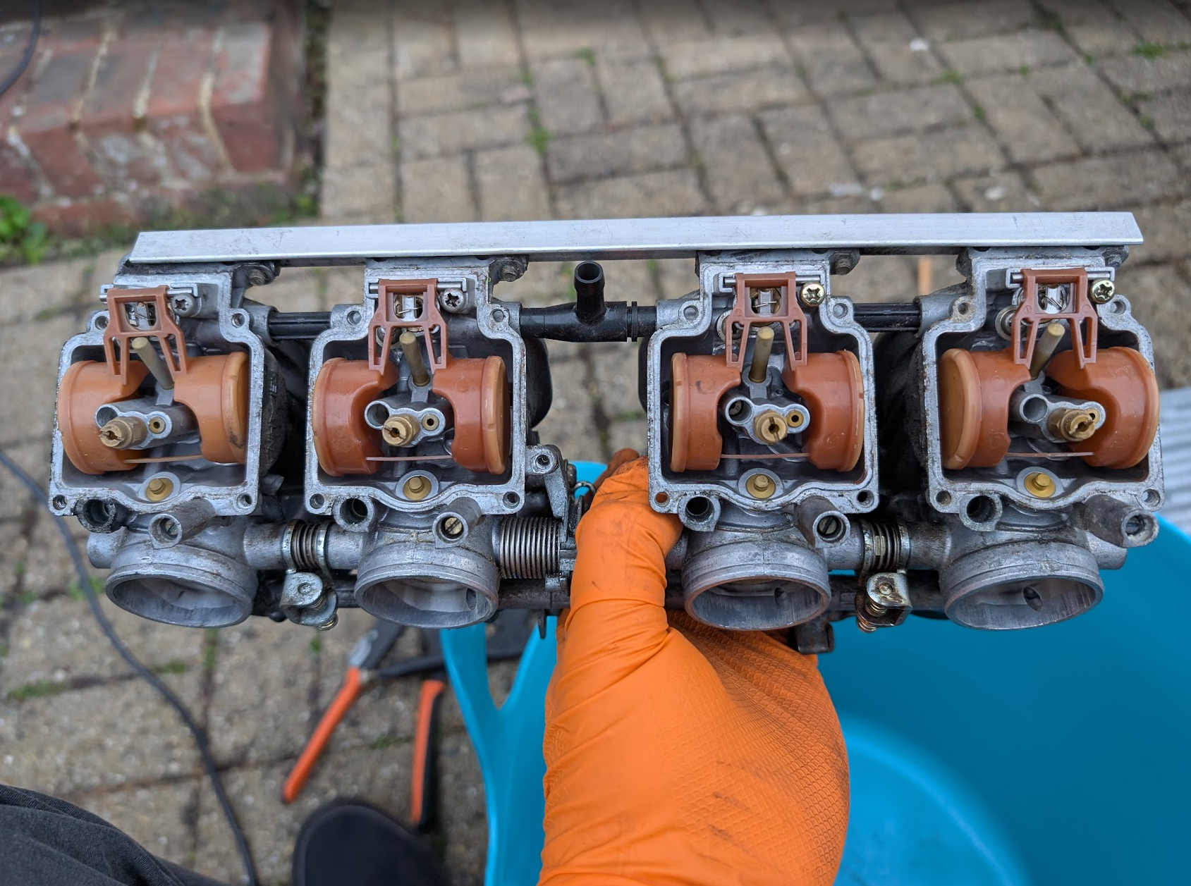

Bowls removed, one of the float pins was loose AF which is probably why the oil is full of petrol. You can see it on the left in this photo:
After 20 mins in the cleaner. I still need to go over them with a brush to clean the muck off the outside, I left it there to see just how well this ultrasonic cleaner works. The answer is terribly for muck, but spectacularly for the tiny stuff:
Carb rebuilt kit should be arriving on Monday, new float pins and seals and stuff.
A few observations was that there were more non-standard screws holding things together, just proving even more that this was owned by someone who maintained it on a whatever-we-have-lying-in-the-shed budget. The ultrasonic cleaner is a game changer. I'll likely order my own fairly soon.

You’re /We’re going to need to check your piston rings if you’ve got petrol in oil. My limited carb knowledge would suggest that a float that doesn’t move properly either means that carb floods or it doesn’t get enough fuel. When the float rises there’s a needle that plugs where the fuel is drawn in, essentially to stop the chamber filling up more.
From my limited research, the poorly tightened float resulted in the cylinders filling with fuel. Then a couple of years standing still means that the petrol will slowly seep past the piston rings and in to the oil.
Of course a compression test is required, but from a mechanical point of view it might actually not be as bad as initially thought.
Which is Diddums speak for "best start learning how to rebuild the bottom end of an engine" :p
My van suffered from it, ended up figuring out that the vaporised fuel was condensing in the intake manifold, then the spark simply can’t ignite it as a liquid, so ran like **** and dumped what it didn’t burn down the sides of the pistons.
I hope you’ll be ok with bottom end, if the fuel has perished seals, and oil and water are getting into places they shouldn’t, that’ll be a pain.

Carbs are looking better! Don't forget to chemically clean all the tiny little passageways as well - it'll really help
Whatcha mean chemically clean?
They're going to get another sesh today, however focussed more on the outside with a brush. Then another 10 mins in the cleaner, they they should be ready for reassembly when the rebuild kit arrives, hopefully tomorrow.
Proper deep clean today. I reckon it's lost a few kilos in road grime and muck:
