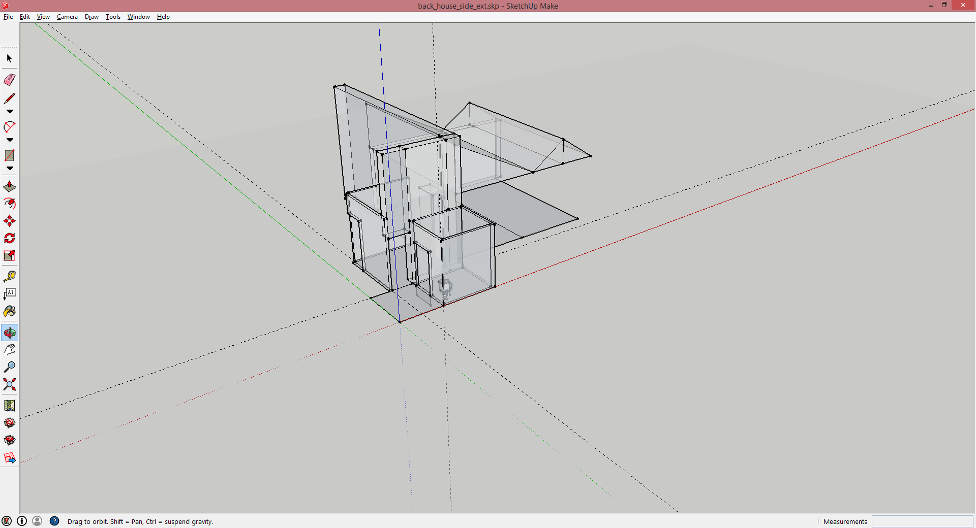

Just starting to think of ideas for kitchen extension. Bit of and odd shape to rear of the house.
The large area at the back is an 80's kitchen extension, the square area is the original kitchen with the original external wall in between, hence the large doorway.
The bit off to the side is a 60's extension which leads out to a downstairs toilet in the first room on the right, at the end is a door leading outside, with two further outside rooms. One is used to store the washing machine the other has an outside toilet which isn't used
The 60's extension needs to come down and be replaced as it's served it's use and has some large horizontal cracks on it's side (down to no foundations I believe, main house is fine). We would however like to keep a downstairs toilet and perhaps somehow add a shower room.
As for the kitchen we were thinking of going out another 3m into the garden, perhaps some sort of conservatory.
I'll add more pictures/detail if required. Still very early stages yet. Also still getting used to sketchup

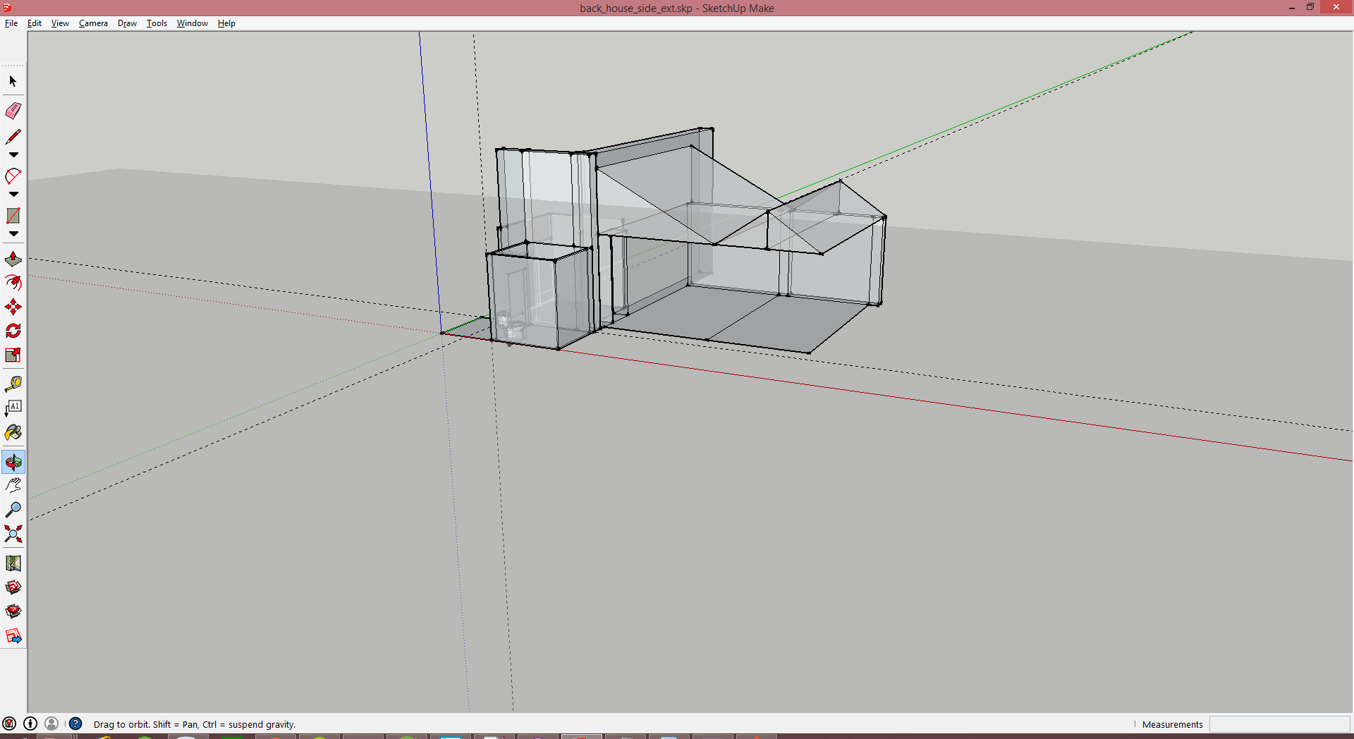

Slowly getting thoughts together
Idea is to have a large amount of glass in the new roof section
Keeping the size of the side extension the same but increasing the ceiling/roof height, having the right hand side as a bathroom/toilet and the bit to the left has a 'dirty' entrance plus space for boots/shoes/coats that sort of thing
View looking back from the front of the house. Garden is north facing but large enough to get lots of light
No idea if any of this is feasible/affordable yet, getting ideas together o show an architect

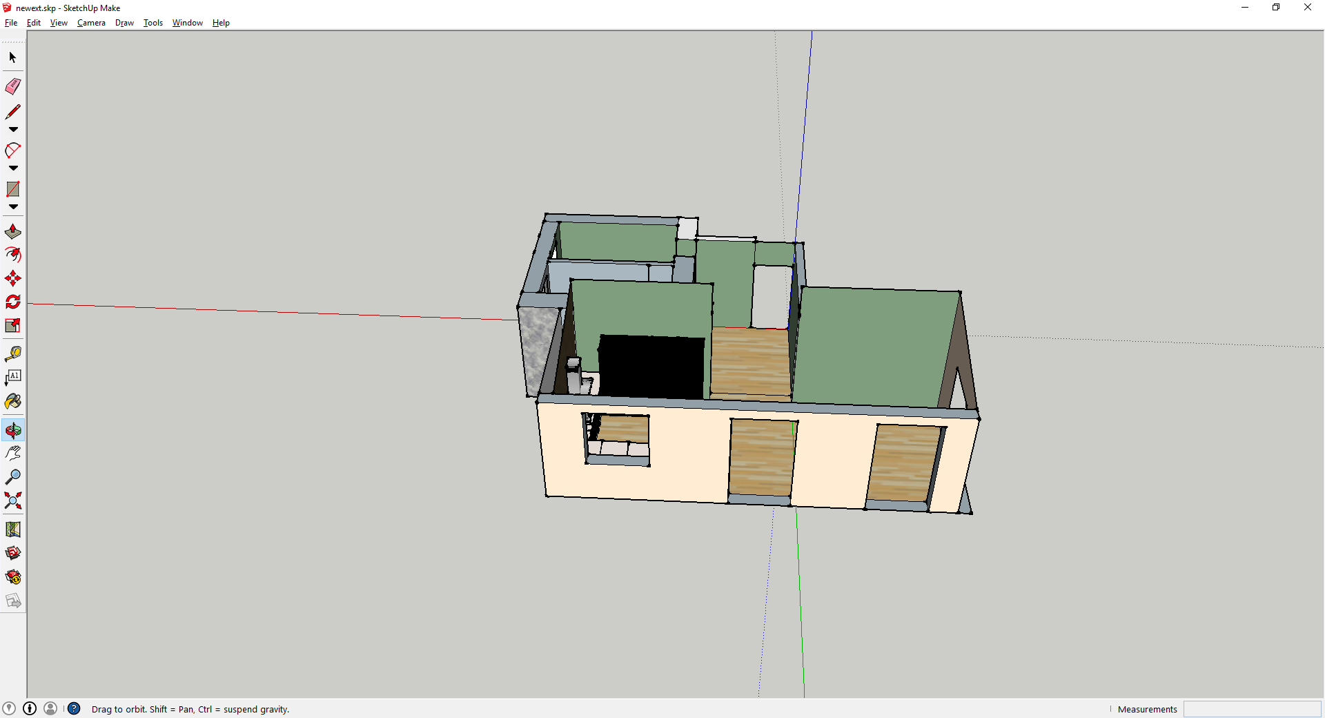

So it's been over a year since posting this, one crappy architect and one good architect later, we're about to accept a quote from a builder to do the following.
So instead of go out into the back we're going sideways instead, we're also doing a double story at the side which will give us a fourth bedroom upstairs, the room I haven't textured is a shower/toilet room.
The main kitchen itself will be 28m^2 with the bit added on, have two french doors a vaulted ceiling and three velux windows.
Just trying to get ideas on the finish now and the above is what I've come up with so far. Will also have to think about lighting, there will be some wall cabinets on the brick textured wall so undercabinet lighting there, the breakfast bar bit will have some dangly lights (don't know the technical term) also thinking of having a couple more of those somewhere in the middle of the room where the dining table will be sat and perhaps a tall lamp over in the corner somewhere where we're likely to have a corner sofa. Will hopefully also have a log burner on the far side

seems like a very narrow room with two openings taking most of the wall space, you should have a look and see how you think the furniture is going to work in there and still let you move around it - or is it just a dining table in the middle of the space and nothing else?
No that's me playing around with sketch up, having a chat with the builder tomorrow to go over the quote in detail
It is 3.5m wide so not too bad, there'll be an extendable dining table in the middle and a small corner sofa in the bottom left corner of that last picture
