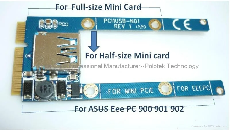

There's (internal) mpcie to USB adapters. Assuming you could get a headset with a small enough dongle there's a good chance you could get it to sit in a possibly unused mpcie slot? :)

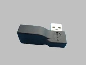

Alternatively a 90 degree USB adapter that allows a small USB sound card to sit (fairly) neatly against the side of the machine? There's ones that turn to the left or right rather than just up/down. My wife has one in the laptop as she's had a habit of destroying the dongles (despite being careful).
