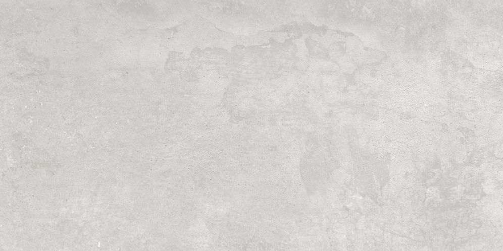

I am currently looking at tiling options for my new kitchen and a recent trip to a bathroom store found me gazing longingly at this tile:
It is a large-format, porcelain tile which is almost exactly the colour and finish I want. It is close to perfection... but I still have others to look at.
Anyway, my initial thought was to run those in portrait, from the worktops to the ceiling. This is a render of what things should look like, layout-wise:
I was wondering if laying the tiles horizontally, in a stretcher-bond design, would work. Like massive bricks. Thought was to try and bring some of the detail from the exposed brickwork in the dining room into the kitchen...
Technically, will it work? My brain tells me it's now harder to lay as there are multiple edges which need to be level, but surely that's not out of the realms of possibility for a quality fitter... right?

Woah woah woah, that image is just an example - each of the tiles will have a slightly different look to them. Just tiling the image of a single title isn't going to give you how it will look on the floor/wall.
Because it's not a natural tile you'll likely find the pack contains between 5 and 8 different looking prints and part of the process of laying tiles like this is trying to avoid having two identical tiles next to one another to make it look more natural.
Also, with large format tiles I personally think that straight lines (rather than brickwork) look better. Like the example image on the website shows.
ALSO also... you can see how different the tiles look on the example image on the website but at the same time I think I spot some duplicates. These two look the same, just one is upside down.
Yeah I'd agree you don't really want a repeating pattern anyway. Looks more interesting if the pattern differs subtly as you go.
I am not averse to that. As the tiles are rectified and can have minimal grout between them, straight lines could look rather slab-like, which might be a good thing or a bad thing.

I think with a tile that size I wouldn't bother with stretcher bond, just get colour matched grout and do as fine a grout line as you can and it'll look sweet (you are going to end up with a lot of wastage to do the infill piece at the top (you'll have about 300 deep pieces so you'll get two out of a tile...)

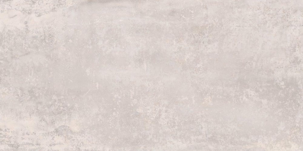

Found a couple more options on my travels today; Azteca Studio 120.
White:
Which looks like this:
Grey:
Can't find anywhere in the UK that actually stocks it - found it in a tile shop, but even their website doesn't mention the range.
I must confess I am a fan of a simpler pattern/colour, a little variance is OK, but for me I prefer that to be quite subtle. I guess what I'm saying is a distinct pattern can look good in isolation, but extend it out over a larger area and it becomes harder to imagine it looking as good to me (again, a more personal thing perhaps).
