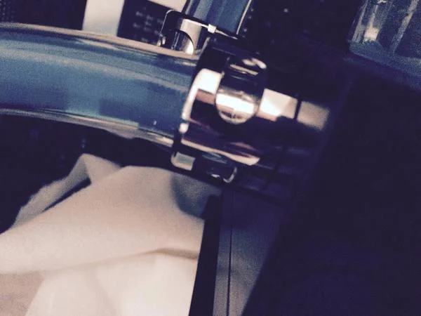

So I've just started filling my loop and the res inlet port is slowly leaking, I've already tried changing the fitting and o-ring, anyone got any ideas?
It wouldn't be because I'm using my fitting directly onto the port would it? Should I have used a 1/4 fitting and attached the 3/8 5/8 to that?
Have you attached the extender that was supplied with the res. I had same problem but when I attached the extender it stopped. Check the instructions that will confirm it.
Having read the installation manual I now see the error of my ways, thank you Viberious! Now to drain the loop enough to let me remove that without too much leakage

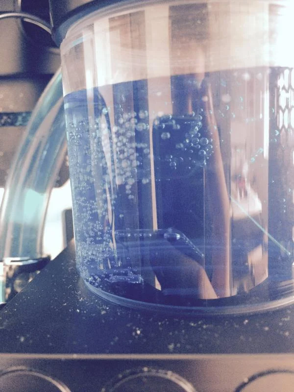

So it isn't leaking anymore, it's just vibrating quite a bit making it loud and there seems to be something funky going on in the res?
Sounds like you got it set to full speed,turn it down to step 2 or 3,makes a big differnce to the noise and turbulance. Its normal to have bubbles in the res,after a few days of running they will reach the top of the res and dissapear :)
