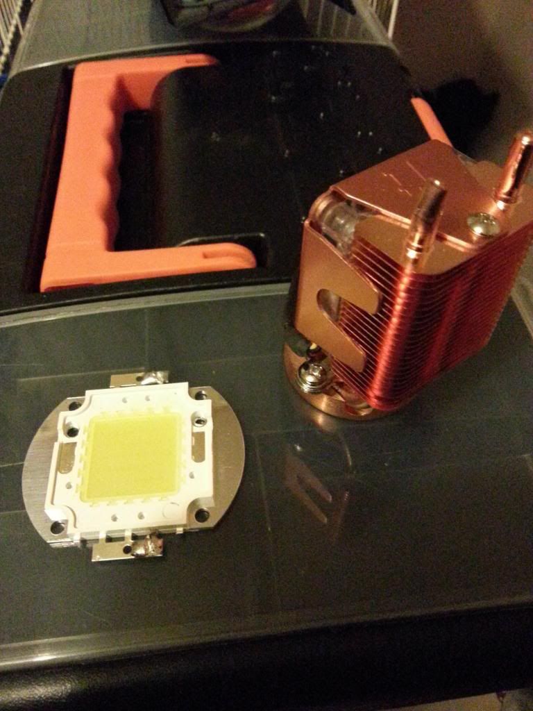

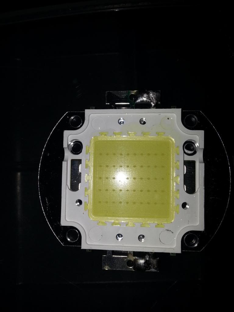

There is a minus on the left side below the hole on the white plastic section of that's of any use?
Edit - positive symbol on the right too, just harder to see.
The top as you have it in pic is +
Its a bunch of diodes, so will block current wired backwards, i.e it'll only work one way.
Is that heatsink for a cpu or a north-bridge? It puts out a lot more heat than you'd think (yeah ok 50w) but over a small area so make sure you have some air flow on the heatsink or its going to cook.
You sure its positive at the top? And it wont go pop?
Dunno if its any helpful as the comment doesn't make much sense to me but I saw this on the subject:
"look at the led chip and the side that has the positive is the lead. so when you look at it it will have a little more towards the top and that represents the marked location"
Thanks mate, But that's referring to a normal LED with the two legs where the longer of the two is the Positive :)
Thanks :)
Yes its positive at the top, what are you planning on powering this with? They need a constant current 30-34v dc psu. Pop? It'll kill itself in seconds without decent cooling, did I mention how hot they get?
I have a 36V LED Power supply it came with it.
This is removed from a 50w Flood light.

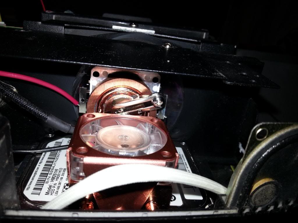

Will that Copper sink not supply enough cooling? :/ If not im going to have to find something!

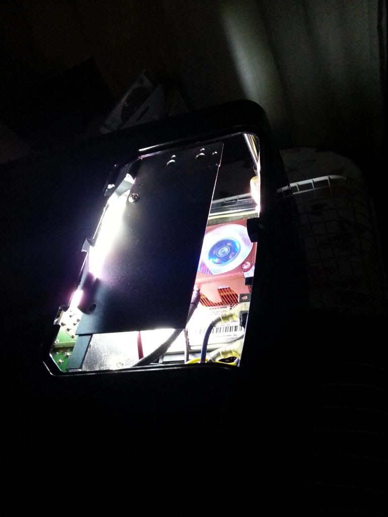

Well.
It works. The heatsink doesn't get too warm with an 80mm fan blowing at it.
Thanks for help with polarity :D

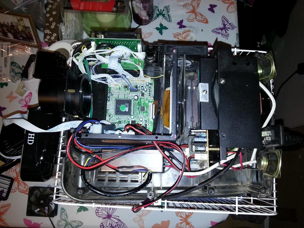

Some pics
The light needs some reflectors and pulling back a bit. At the moment im looseing a lot of light out the sides and when its too close to the lense it actually gives less light.
So I will make a holes in the rear for the heatsink to pop out so the light is further out.
Soo its good so far. Much quieter and slightly brighter.
