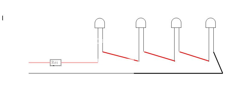

What are you looking to use for colour? Was it Red LEDs you were using?
..looks in Documents folder for previous wiring diagrams..
So the above is a simple independent wiring diagram for a string of 4 LEDs that work in series. The 'RES' box is where a resistor goes to drop the voltage provided to each LED.

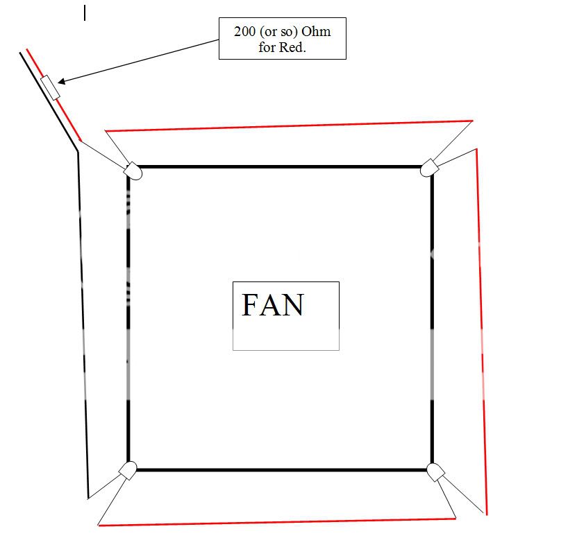

If you are looking at Red LEDs then you'd need something like a 200 ohm resistor.
As for dimensions of the wiring I have no idea. What I'd do is pop the LEDs into the holes and add the wiring afterwards. The LEDs are polarised so will need to be pointing the same way around the circuit. You can see from the image avoce that the long leg of the first LED is connected to the +12v wire and the short leg of the last LED is connected to the ground.
Maybe this will help. I'm far too nice for my own good you know.
