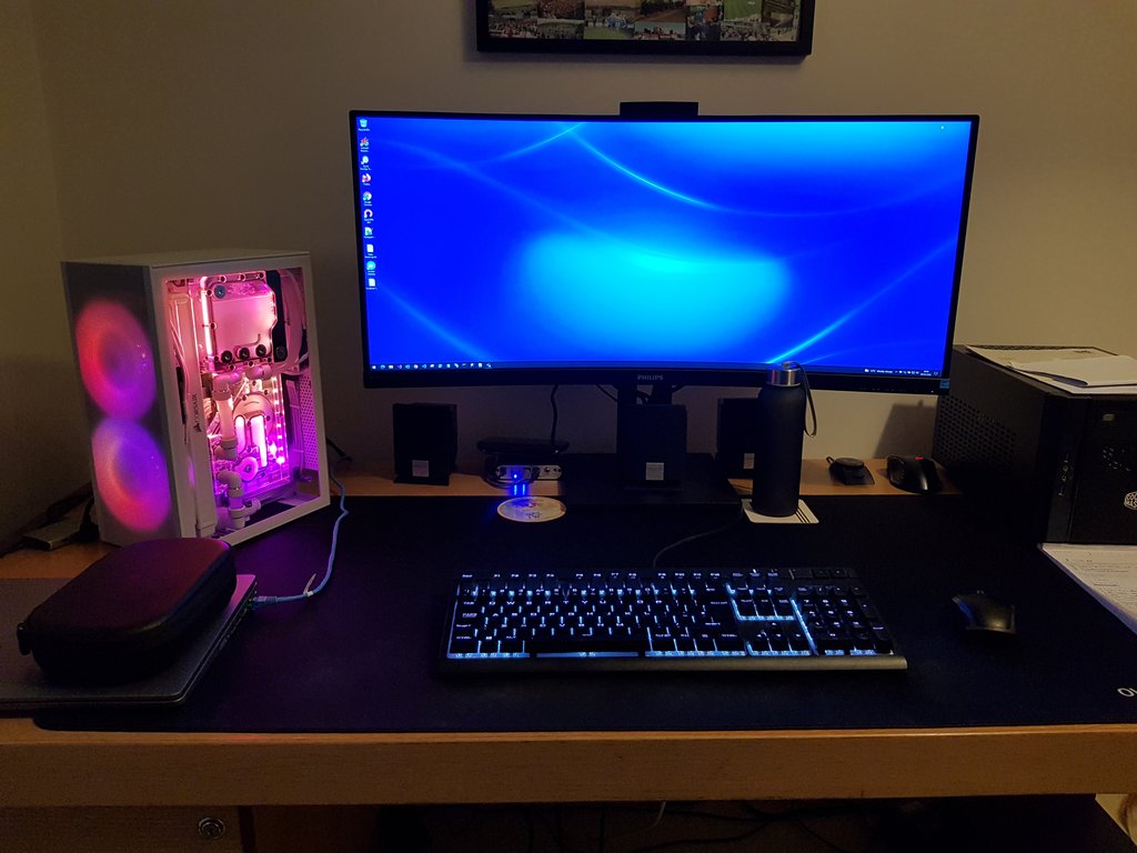

Sounds a bit like what I wanted to do. I went with the meshlicious, previous to this I had s bitfenix prodigy which can be inverted too.
Yup, that's pretty much what I'm going for, and for what looks like the same reason - the drawers on my desk are on the left so I have to sit at the right side of it!
Exactly, I also have another small PC on the opposite side, anything large blocks the door way to the right of the desk so the best place for it is on the left of the monitor. Plenty of room for a bigger PC but I've now got to accommodate a works laptop too.
