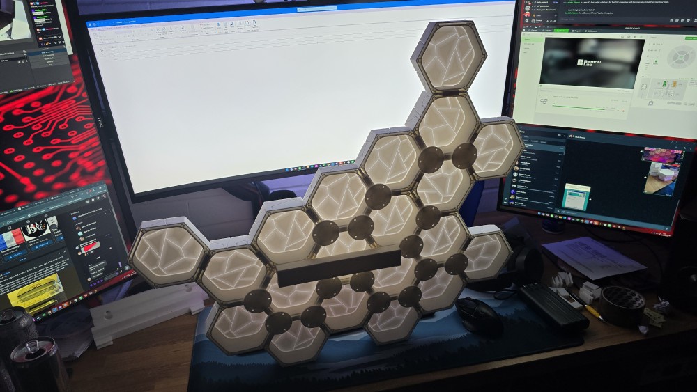

Working on this, quiite fun but time consuming.
And from the rear.

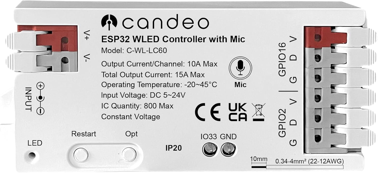

Using a ESP32 controller for alexa intergration.

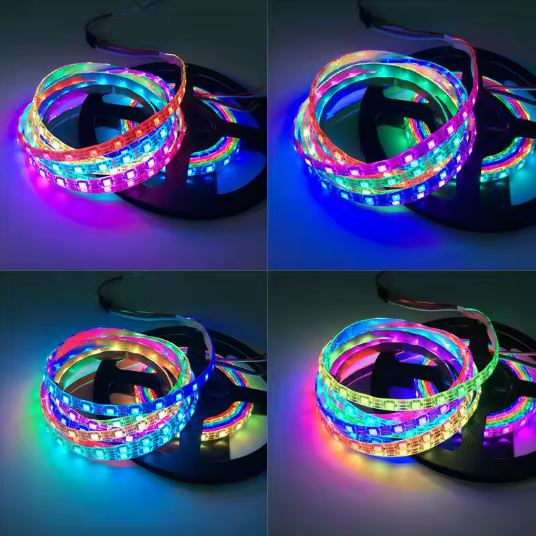

The LEDs I'm using are: 5m LED Strip Lights 60LEDs/M RGBIC WS2811 Light Strip

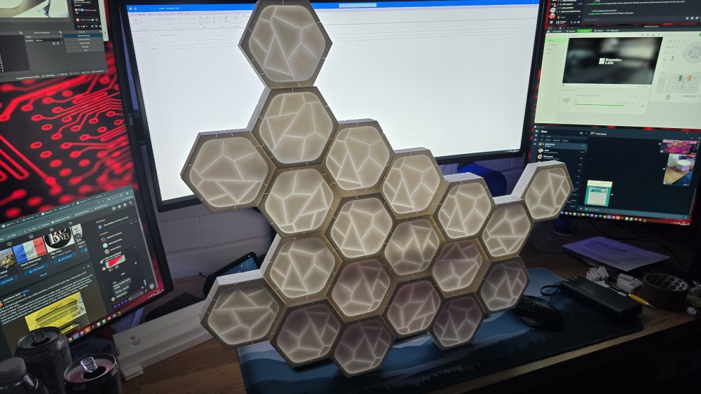

Here is the finished result.
I used a different connector on mine, although there's huge benefits in being able to have it modular etc etc, once it's up on the wall i'm not going to break it apart so the connectors are useless....
Soldering all the connections is a good solution, I almost wish I'd gone that way.
Thanks, I really enjoyed doing it as well. The cost savings vs a Nanoleaf setting is good, but for me the fun was the making part, and putting it all together etc. It feels really satisfying doing this.
