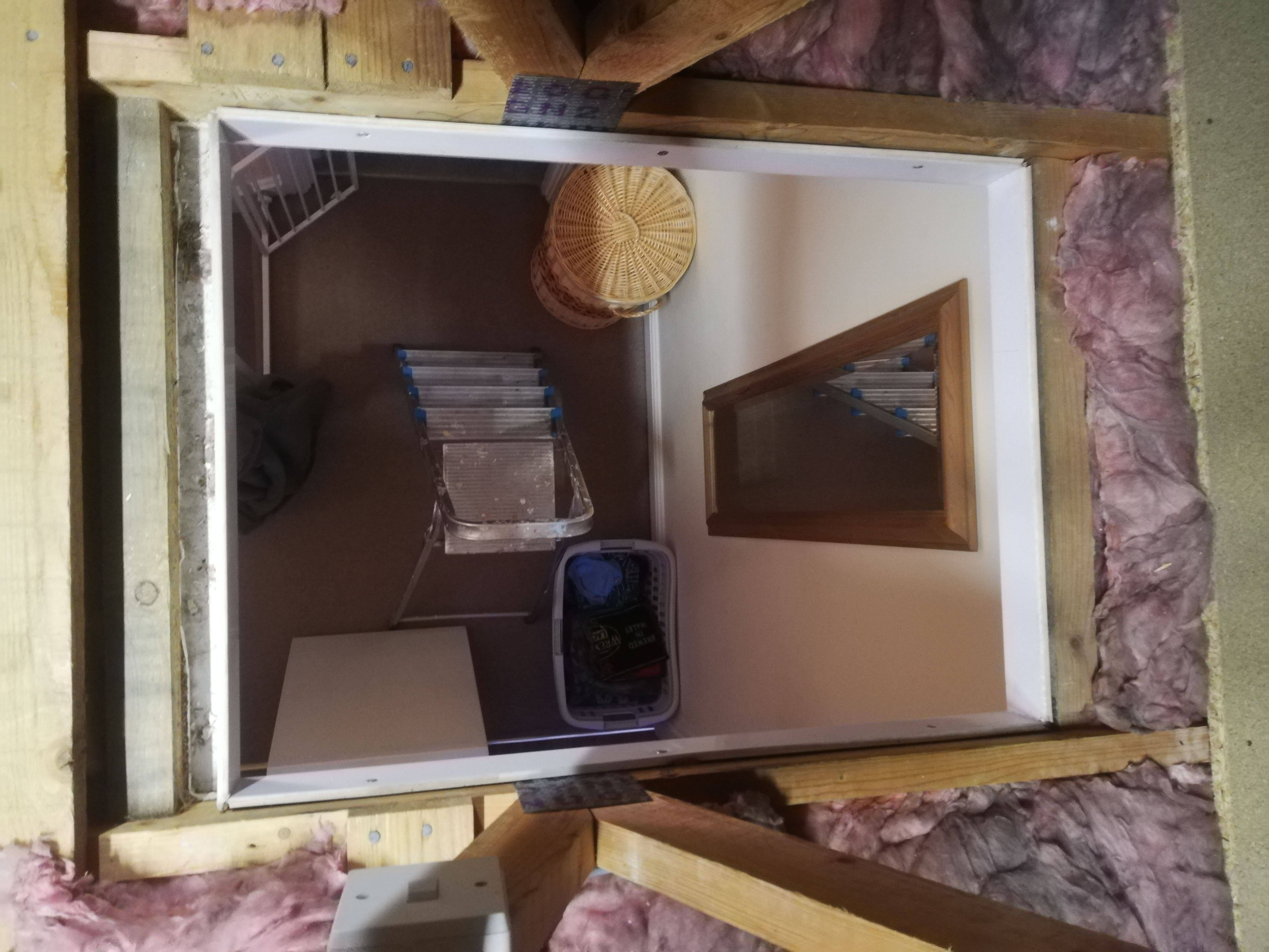

I've measured the area (give a take a few mm) the hatch opening is 760mm x 560mm, the space between the wood is 800mm x 570mm
The length (left to right as per the below photo) isnt that important, ideally doesnt want to be much smaller, as that'll mean I might end up with a gap in the plaster board which I will have to put right and it'll never end up looking 100%. Plus it'll mean I will have smaller access. Those bits of wood at each end are not strucutral, they have been nailed in there, I will need to take one out (left side as per photo) anyway and put a better bit of wood in so I can bolt the ladder to it. It can be longer maybe 50/100 mil either way should still fit nicely.
Width wise (top to bottom as per the photo) obviously needs to be pretty spot on.

Have you got anymore insulation? If you don’t, add more.
In your picture you look to have <100mm between the joists and the hatch isn’t insulated either. Your place must cost a fortune to heat.

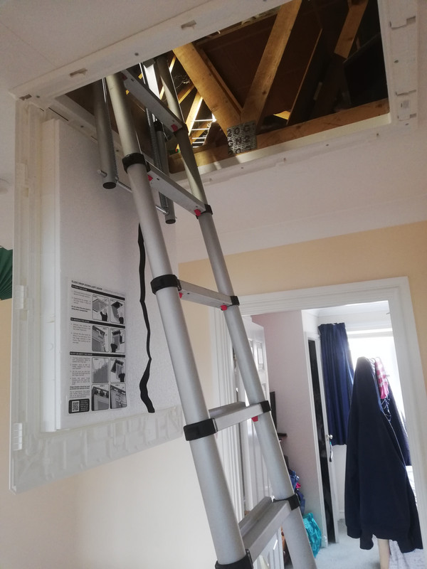

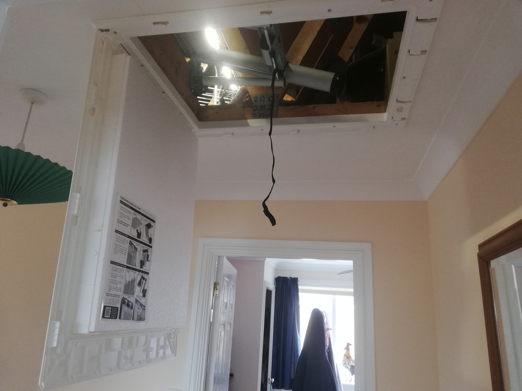

All done.
Ended up just getting the hatch in my first post fit almost perfectly, ladder is telescopic and just collapses up on a sprung bracket. Really easy to pull it down then just put it back up.
