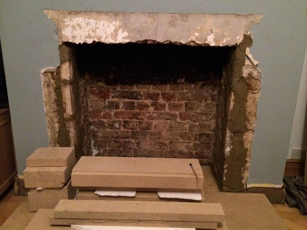

Anyway, fire place installer turned up on Thursday morning and announced it was going to longer than a one day job. Fair play to him, he did 9-5 on Thursday and the arrived at 4 on Friday and didn't leave until 10pm. He could have rushed his way through but he didn't and I'm glad about this.

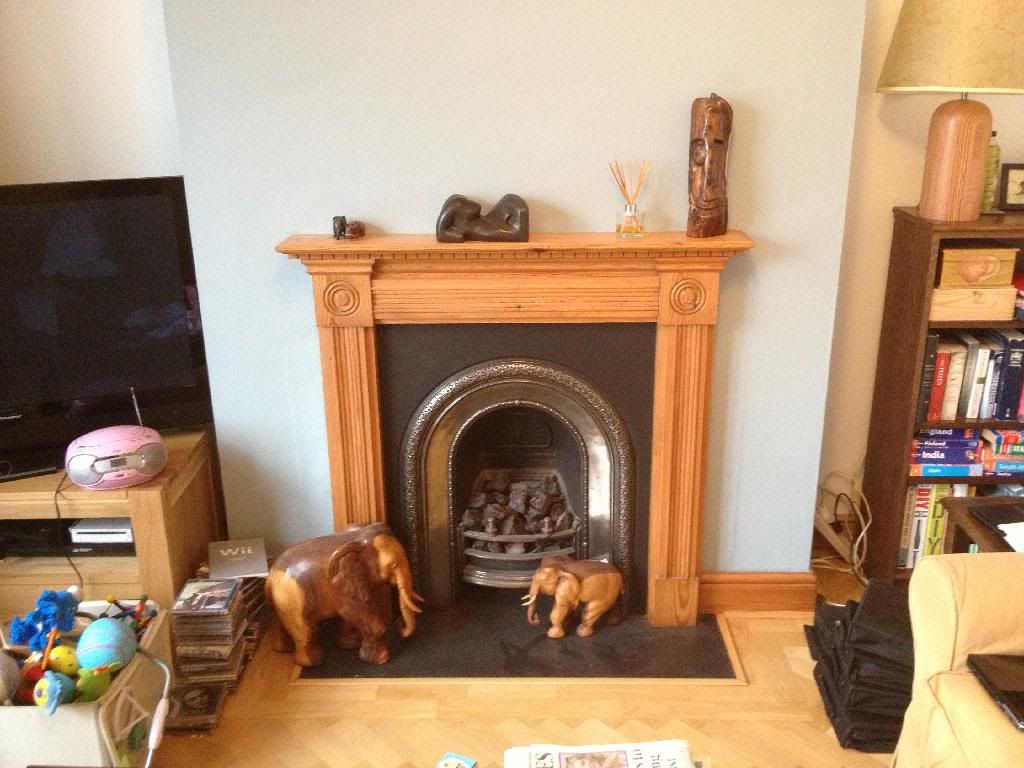

From this:
via this:

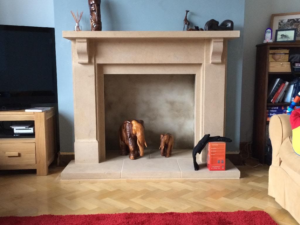

to this:
[/URL
Very happy with it. Will be even happier when there is a stove in there.
Nice job,looks good
Hope it stays as good looking in the following years :D
Soot and wood charcoal is a bugger to clean off if ingrained :)
It's rough(ish), not marble smooth.
I've been told that it should be easier to clean (and more resilient to dirt) than the light / white Portuguese limestone ones you see. Not too bothered about that, but we'll see,
