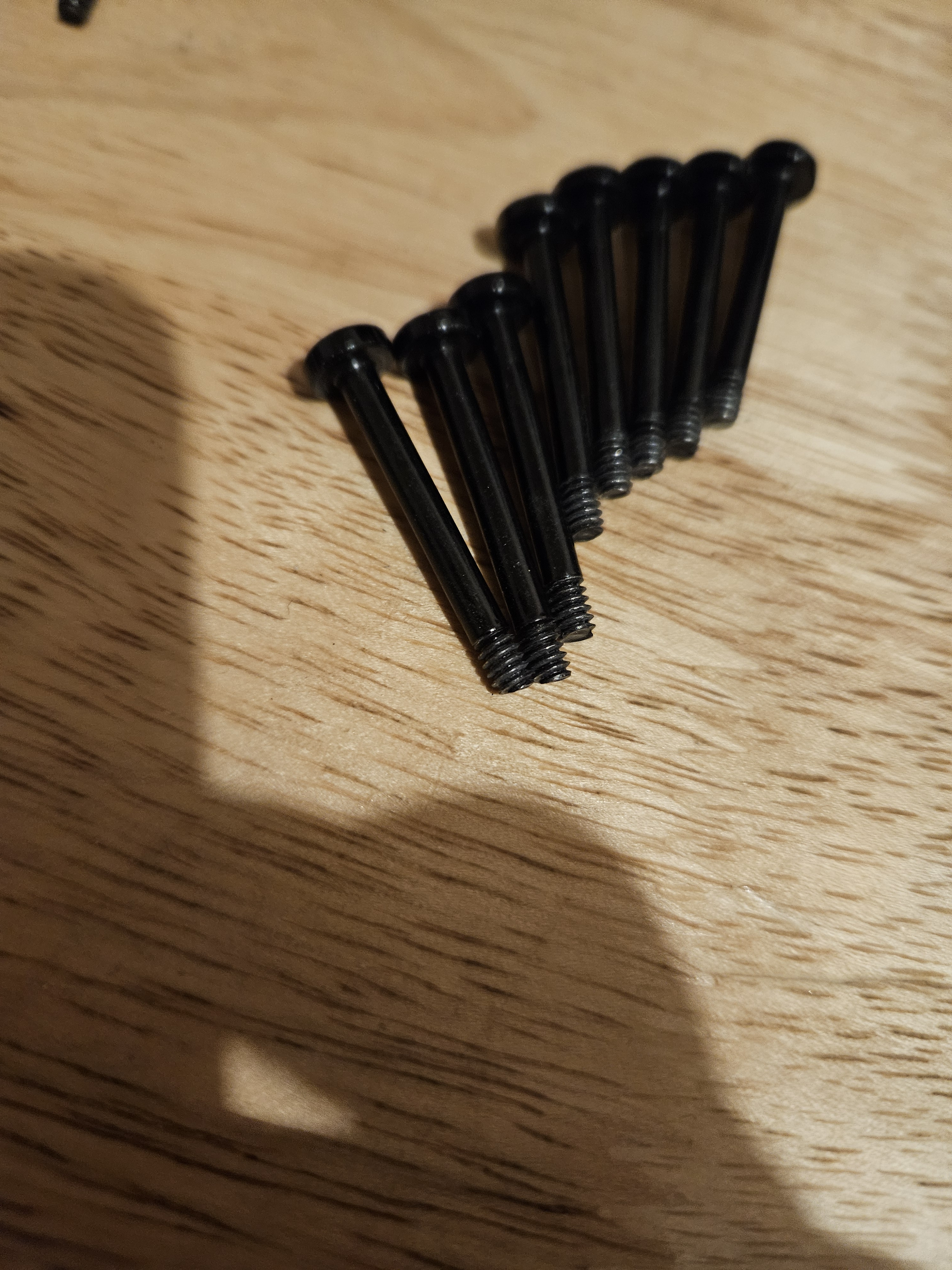

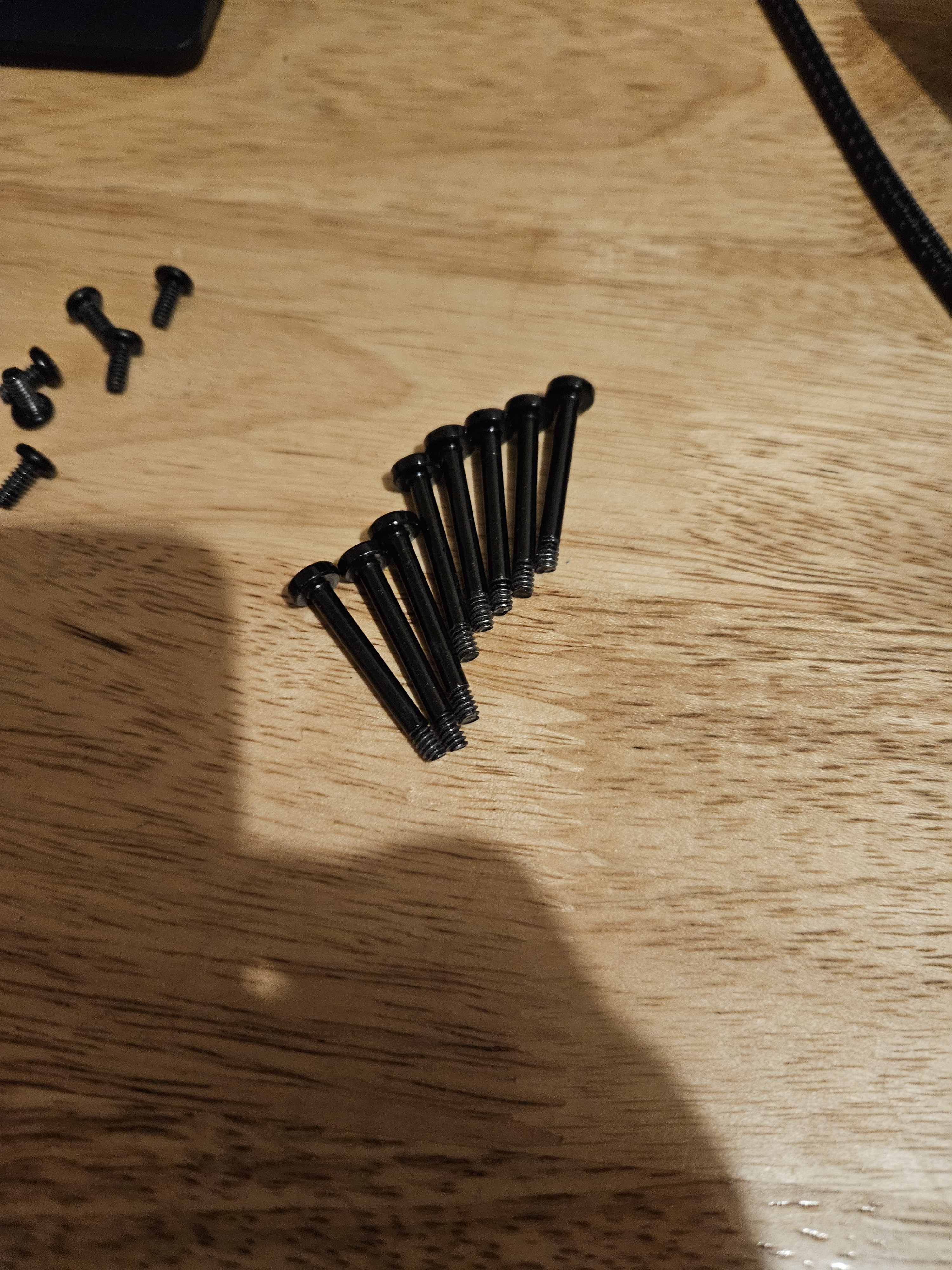

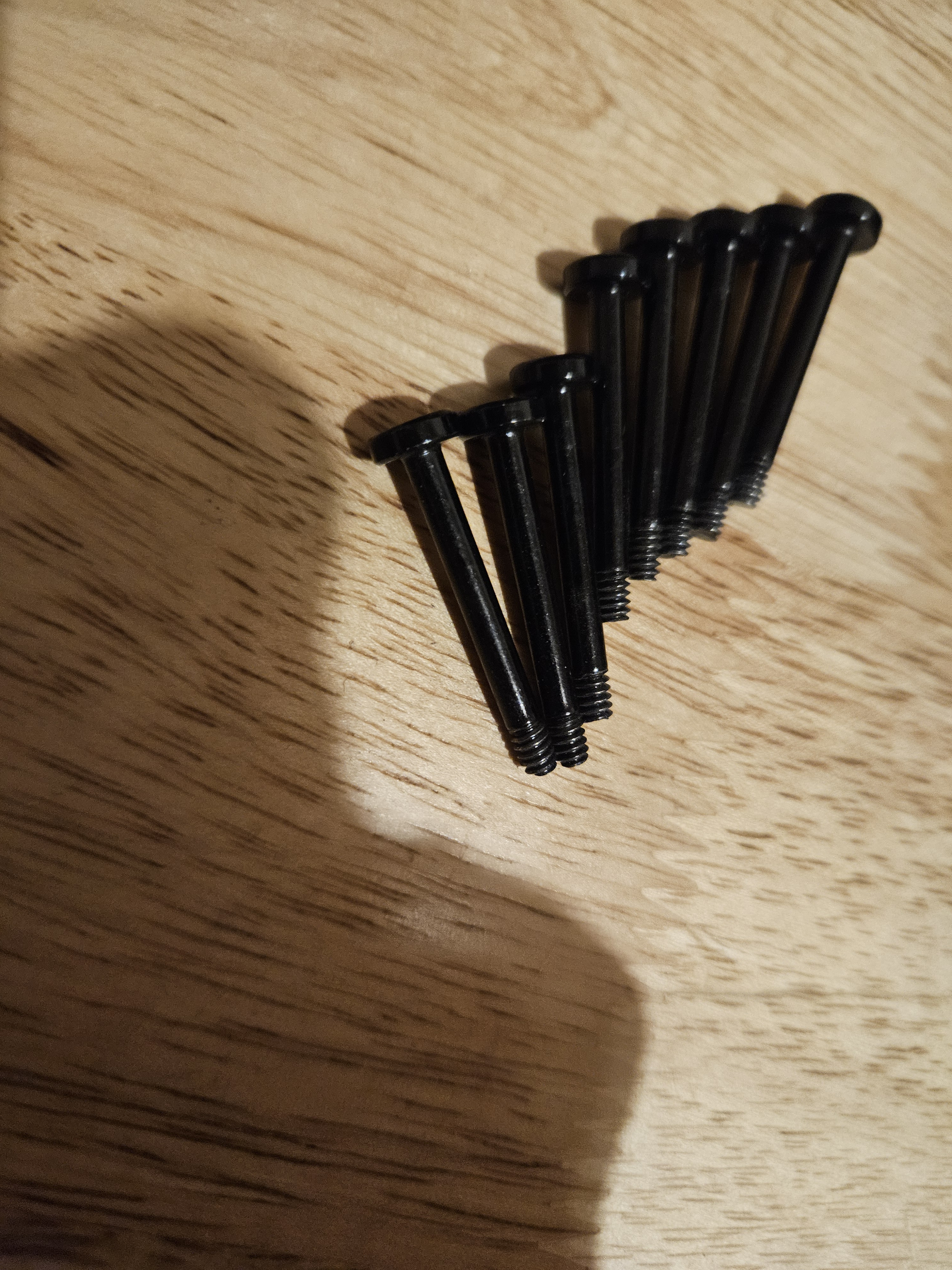

I found some 35mm ones on Amazon, expensive for what they were but was looking for something specific (hex button head, black). Mine were metric M sizing rather than UNC though.
