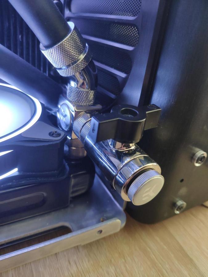

Would recommend one of these for filling, especially on a distroplate where the fillport is hard to reach ;
https://www.overclockers.co.uk/ek-water-blocks-filling-bottle-1000ml-wc-9ej-ek.html
Also a drain valve somewhere ;
https://www.overclockers.co.uk/ek-water-blocks-ek-af-extender-rotary-m-m-g1-4-nickel-wc-9hs-ek.html get 2 ( rotary so the valve can be faced to the correct orientation )
https://www.overclockers.co.uk/ek-water-blocks-ek-af-t-splitter-3f-g14-nickel-wc-944-ek.html ( rotary screws in one end / rotary+valve goes on one hole / fitting goes on other )
https://www.overclockers.co.uk/ek-water-blocks-ek-af-ball-valve-10mm-g14-nickel-wc-900-ek.html ( the valve itself )
https://www.overclockers.co.uk/ek-water-blocks-ek-csq-plug-g1-4-for-ek-badge-nickel-wc-619-ek.html ( just in case to plug the valve )
Will look like this ;
Totally forgot fill and drain! Thanks.
